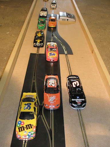

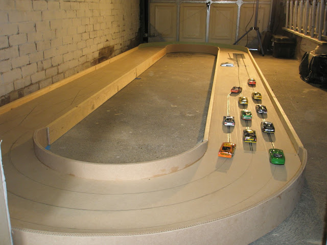

So our Oval is all but built so now we need to move onto the actual running of it yikes.gif
1. Software to run a race meeting. What would you use ?
2. How do you make a cable to connect the PB to the computer ?
3. JCS100 our electronic wizz would like yo build a Digital controller ohmy.gif
4. How do these controllers differ from a normal controller ?
5. We need to put in driver stations to pug our controllers into is this just a case of a lead from the PB to the Station That we then plug into ?
Anything else that you think we have missed ?
And so you can see here is a photo of our new track
And a fullish view - This is before it was completed
Thanks in advance for your help

Are you going to bank the corners?

No thread as such, I did post a simple explaination Here (it's quite simple).

QUOTE (distantkiwi @ 3 Jun 2010, 12:01) *
Not on this incarnation but was talking about that last night and there will be a banked corner soon
Want to get this up and running 1st then we can modify it as required

Michael... very interesting design in combining the prefab lane changes with routed runs!!! I dreamed about something similar when I had my digital setup. Looks like you've executed it perfectly! One advantage to an external power supply I've found is the ability to quickly adjust the track voltage for different classes and/or driver types. I have not found the metering to be all that important, as I usually check voltage at the rails with a multimeter just to be accurate anyway.
Do you have a link to other pics of the construction of this track? I'd love to see more.
The build thread of our Digital Oval
PS Lee built it but he does not visit SF so I have posted all the details for him
