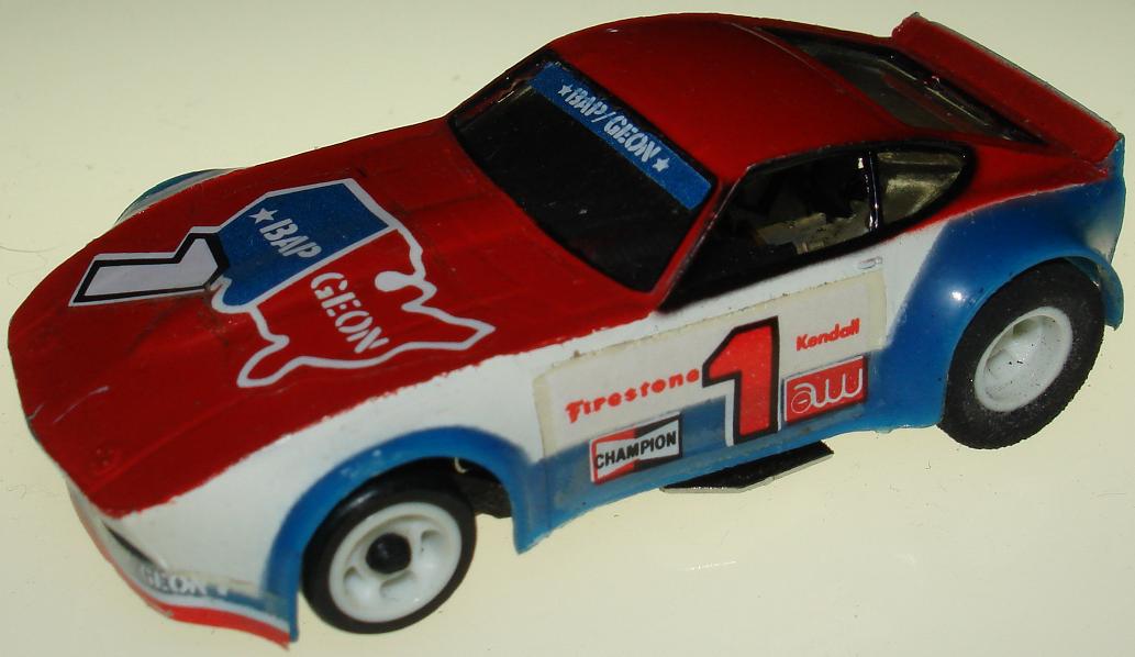

I never found anything to match the F40, especially as it uses the narrow 'F1' chassis as opposed to the wide chassis, and has a short wheelbase. I suspect if you tried to mount non-MR1 bodies you might find something even better, but the chassis are bulky and make doing that hard. The ultimate closed wheel body is considered to be the Rokar Datsun 240Z.
That often get used on Tomy and Tyco chassis, but no idea if it would fit the MR1. Doubt it.
The fairly new AFX GT40s are considered really good race bodies, and they would convert I suspect smile.gif
