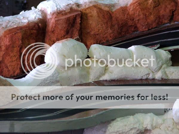

Expansion foam used on the left end as fill...
Boulders carved from expander foam between tracks. Expander foam has also been used to fill between middle and bottom layer of track, this area will be later cut back to a gentle slope (probably) and either finished as a small erosion slip of scree and gravel or planted with low shrubs.
And expander foam applied at right end of table to create hill...

Well, Tuesday was Melbourne Cup Day. My first Cup Day off since leaving Melbourne for the western edge of Victoria 8 years ago (that long... sheeesh, no wonder I now feel provincial when in the big smoke). Spent the day doing a bit of work on the track, so it's update time.
Trimmed up the foam-o-fill ready for application of the ever present jointing compound.
Jointing compound applied. This area will be a combination of rock and scree, with the big boulder on the top, so I decided to use the rock coloured mix. Have also fitted the under-cut cliff between the top and middle straight and started to fill gaps left below the cliff. This photo shows how much the first cliff needs repainting to match in with the rest of it. I've learned a lot since doing it. So, a tip for those working on track scenery, don't start with an area you can't reach and redo if necessary.
This shows the three layers of rock. The front layer in this photo is, of course incomplete. This photo shows one of the little favourite spots in the scenery, which is the cave area at the end of the undercut cliffs and behind the boulders. There's some more work to be done in this area. I have a few little plans, although none of them will be easily visible unless someone is looking closely. But I'll know. Also have to finish the edge of the top track. So much to do.... So little time.
Middle of front loop, below fly-over 180. This area is looking like developing into a swampy area. Just the way the shape is forming. It's deeper at the far end, with rocks placed to form the base for the diagonal straight. A mortared rock wall at the left of this tear drop shape. There will be a culvert draining into this area amongst the rocks at the front. The area close to the camera is a gentle slope up toward the road. Oh, and the posts that were balsa have been replaced with lengths of 5mm square styrene extrusion. I guess that adds AUD 14 to the track spend tally.
Plaster work at the right end is also starting to receive its coat of joint compound. Work has hardly begun on this side of the table.
This is another little area that I love for some reason. I know, it's just a fissure in a rock and the area is not yet finished, but for some reason I like it.
Anyway, that's it at the moment. Not really a lot to show for a day's work.
Thanks for looking in. Cheers
