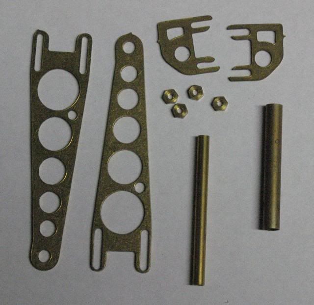

Being a lover of the now dubbed "padlock motors" for many years and using them in various forms with success in local bracket racing, I recently snagged a cool Kemtron chassis kit on ebay…

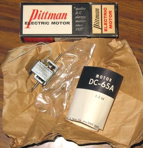

….made for the Pittman DC65 motor, the "Little Brother" of the big DC84 I've used before in a few Hot Rods.
I was intrigued by the boss looking front rails in this chassis kit and felt I had to keep those babies exposed somehow.

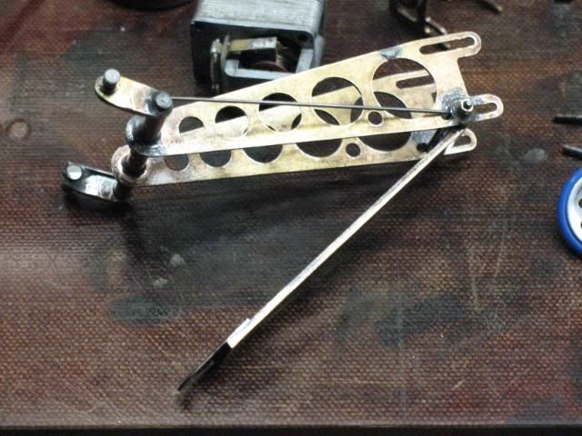

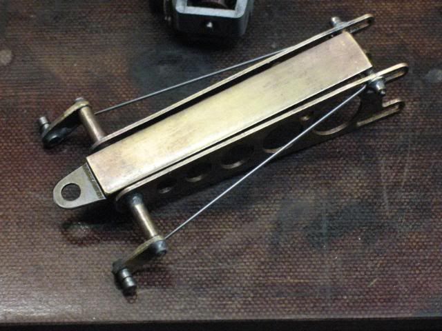

I proceeded to mock things up and then put together the front end with my own scratch drop arm & dropped, spring loaded front axle.
My intention for this build was to create an early 1960's period slot car "rail" in 1/32 scale.
Russkit, K&B, International & a couple other manufacturers had their own rails back then so this would be my fantasy Kemtron car that they might have done, had they ventured into producing complete cars.

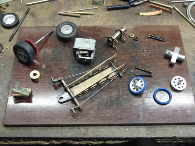

During mock up I squared everything and soldered the rear half together. Here are the completed components before assembly:

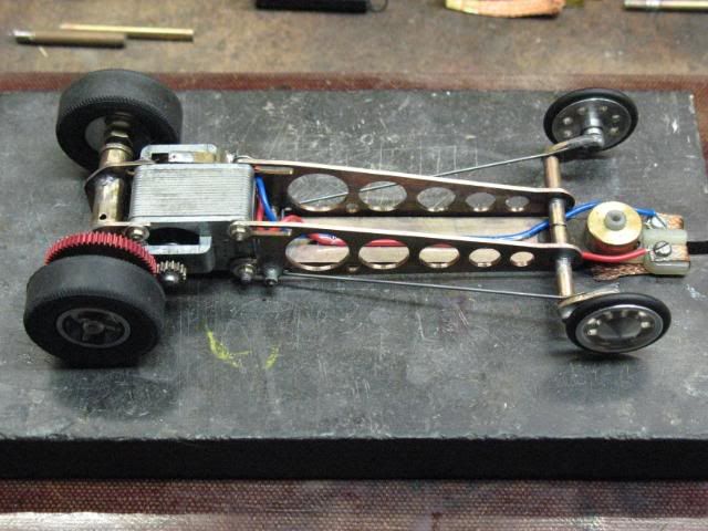

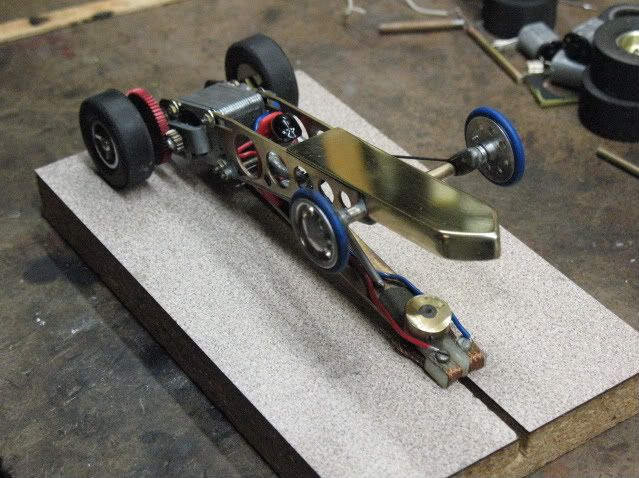

….and after assembly:

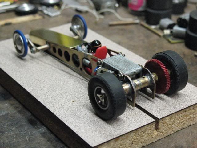

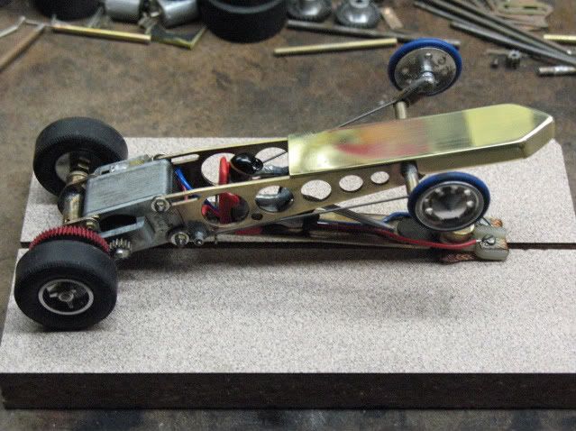

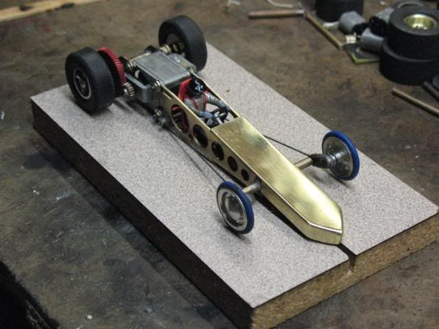

Now it was time to fit a driver. I wanted to do better than just a drivers head on top of the motor so I got to thinking about that open space between those front rails. What a great place for a cockpit! I found a full driver w/seat, as well as a steering wheel and started alterations:
I made a steering shaft out of brass tubing, trimmed up the seat, positioned the drivers arms on the steering wheel, and got the whole mess painted & detailed. I didn't like that ugly guide flag being exposed so I soldered a nose piece together out of .032 brass stock & polished it up. Here is the final result:
I arranged the driver & wiring so that if it pulls the front wheels there will be no restriction. We'll see.

What is the performance like of the padlock motors?

John, the padlock, or more exactly laminated pole motors, can be surprisingly fast, although their weight can work against them. What we've found in dragsters is that they seem to give their best for pure speed at high voltages, say 24 to 36 volts, like the drag races in the 60s. These days you mostly find tracks (like Fred's new track in Burgundy here - see the drag racing thread) which have a standard 16V power supply - and reworked Mabuchis will be happier at this voltage.

QUOTE What is the performance like of the padlock motors?
I think Don answered it very well. My fascination is that they just look cool and are different than the normal run of the mill can motors you see all the time.
The thing I also like is that in bracket racing, they seem to be VERY consistent which is great when you want to win.
We always just run 12 volts in drags, just like any other track. The motors do fine.
