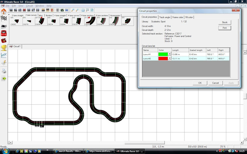

It can be extended with 2 extra straights on all 4 sides at the corner sides left two straights in the middle and on the right side one before and after the wiggly bit.
Problem i see with second one is the need for a 1/4 track piece happy.gif

Only R2's and 2 45 Deg crossovers leaves only a few outside bends in the esses

I would think it was too big. Too many straights and curves for a lot of people. Though I do like the way you have used the crossovers to keep the car on the inside lanes.
There, no 1/4 straight. I'm sure it will stretch and join up.

Nice track michael really nice... just those curved crossovers are not available in Ninco or carerra..... but it works really well but at 12x6 i'm out not got a floorspace big enough...
Trev like the number 2 design... a little bit of ironing and maybe something close to what we need...

Twist on Stefan/trevor's tracks for simplicity but adding some "braking" and a longer straight... so the lap is at lest 3 seconds... this will give 1% differential on a 1/10th second timing... enough to catagorise cars into groups...
So with a few ideas now in the mix anybody like to comment on what we have?
anybody have a preference...
any ideas of what to put into a "poll" for collecting ideas..?

Nice proposal.
Long straight, EssEss and R1 included, no R3 as requested by some..
Works with Ninco also. Length of inner lane is 7.41m:
Imho two drawbacks:
- Width of 3.5m.
- R1 is taken on the inner lane.
However, I would vote for this one.

My vote goes for Diegu's track above.
Have we got enough tracks for a poll yet??
