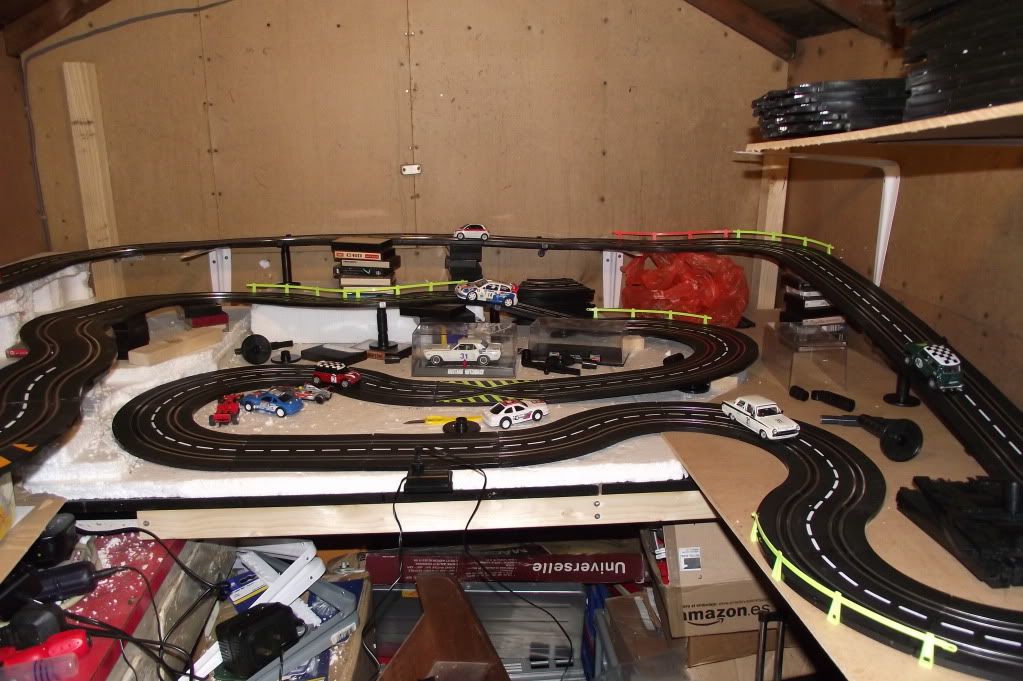

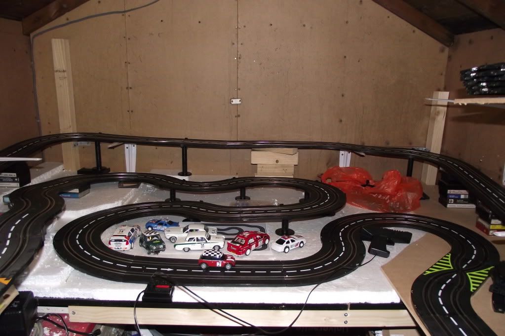

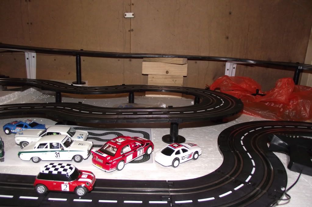

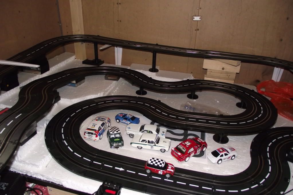

Tracks laid out and tested and seems to be ok
over veiw of track
and closer
the left side
the right side
The layout seems to drive quite nice in an anticlockwise direction and hopefully will be ok clockwise. The elevation levels also seem ok. Most of my cars seem to like it although the Artin track has a lot less grip than the Ninco but as it's going to be painted the grip should hopfully improve.

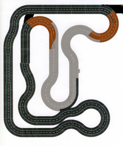

Made a small change to the track layout :-
I've removed the straight and crossover from the return loop at the top right of the track and 2 curves as it comes back to the front straight. This has made room to insert 4 straights in to the middle loop section. This has removed the overlap at the end of the middle loop and made the track slightly longer at approx 19.5mtrs.
in the above drawing the black is tarmac, grey is gravel and brown is earth/mud, this is how i hope to paint the track. The idea is also to paint scenery roads going on to the right at the top right (track leaves road going on to mud track either field or forest section) and also scenery road going srtaight up at the top of middle loop where mud joins tarmac and going into tunnel or under bridge.
Looks like I'm going to have to solder some of the track joints as this layout does not quite join up and the track is losing contact in places.
Still playing with elevation levels but the lefthand straight is the highest point. The short straight at the bottom my or may not drop down, the track is the more or less level untill the 2 straight in the middle loop which both decend with the rest of the track more or less flat. I am trying to keep all the bends level if I can.

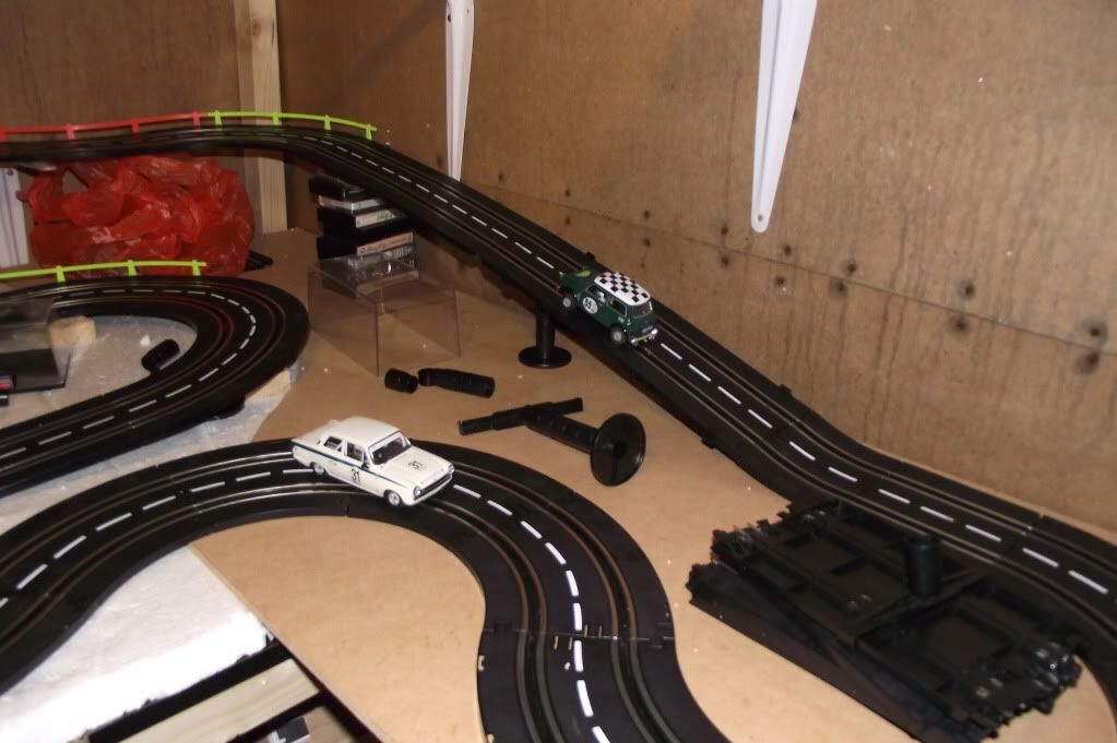

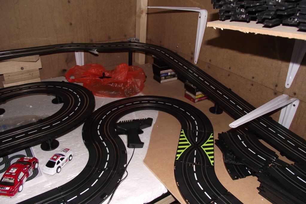

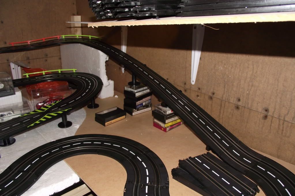

here's a couple of photos of the changes to the layout
This leaves me with one problem, if you look at the diagram the road would appear to continue of the right at top and the same going straight on up and under the top straight from the centre loop.
However as show in the above photos at this point the lop and raising track at almost at the same level. So I have tried a small change to the level of the long straight which will leave me able to have a tunnel or bridge at the point still
This does however give quite a step climb which on the Artin track is to steep. so a question I have to ask to anyone who has used Plasticote paint is how much grip does it give?
A the weekend I hop to wireup my adjustable power supply to the track and the I will be able to test the track in a clockwise direction and then I will find out if the track works both ways, can you get down that big hill??

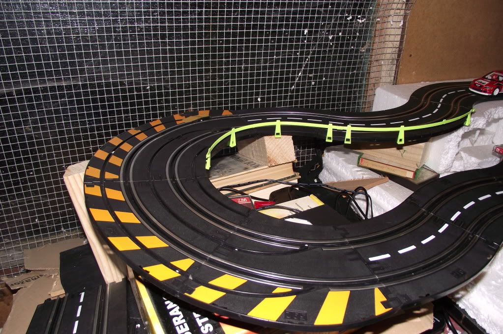

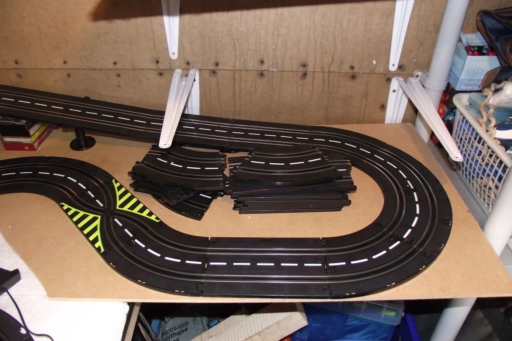

Not done a lot just decided to reduce the elevation height again at the back of the track as the climb on the righthand side was way to steep in the end. I had one car sliding back down the slope, now I'm not using Ninco track I can see what people mean about Autoart cars, just no grip. Also changed the elevation levels slightly on the left of the track.
Also had to lower the entry to the central loop so I can still have a tunnel or bridge for the false road to run to.
Also the Artin Drift curves have got to go (thats the loop on the left with the built in external kerb. This track has 2 extra unpowered slots with the entry controlled by the passing of the car (only works with a pin). As the car passes the entry point the guide pin moves a divider that next time round diverts the car to the unpowered slot and the closes the slot split. So the car alternates between the powered and unpowered slots, which is not what I require. Also you can't reverse track direction as all cars run straight into the unpowered slot. I tried removing the moving wedge and trimming the activating pins off but the is to loose. So it looks like I will keep the 2 middle curves and bin the entry and exit curves.
