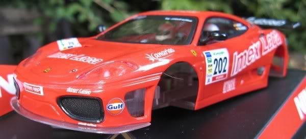

From the front
Note splitter is part of the Lexan Chassis and transparent.

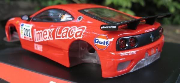

From the rear

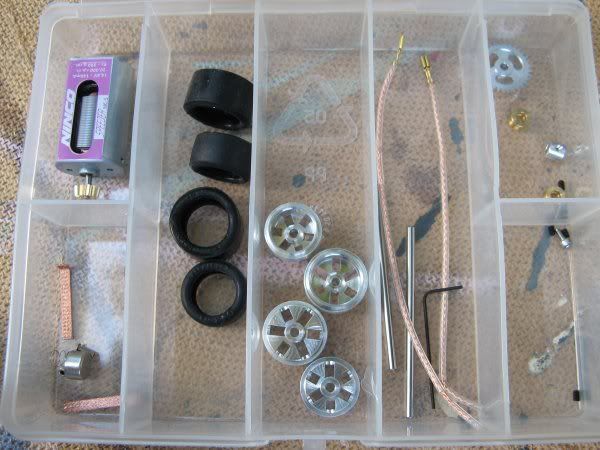

And the box of bits to complete
A few quick notes
Axles are titanium
Rear bushes are not roller bearings as in the prorace Vortrum Mosler
Motor fixing screw included
Interior is pre-fitted ( could do with a little paint on the engine; will investigate later)
Push on motor Connectors
Tampo printed NC6 pinky, a greenie would have been nice if not to powerful
More later if anyone interested

QUOTE (Graymalkin33 @ 18 Sep 2008, 20:11) <{POST_SNAPBACK}>Interesting.
So will you give the splitter and the side vents a splash of black? Or leave them?
Not sure yet, but then I'm not sure if this car should have a splitter and side vents.

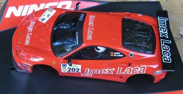

Had a play with the chassis tonight.
Here is the completed article
I had a few little problems.
One of the motor connection tabs was bent out of the box. I did straighten this out but after a dry run it was bent again.
Having had motor connections shear right off before I thought that it may be best to solder, that will also be one less reason to have to open the car up.
Ninco supply a hex wrench for the wheel grub screws but the motor mount screw is a different size. So the screw is left out for now until I either dig out my old allen keys or find my MBSlot M2 screws.
"Final" assembly showed that the front wheels were binding. This was fixed by cutting the offending area of lightweight interior away with Mrs Slotnik's tonail scissors.
The tyres described as "Shore A25" on the box are the softest grippiest that I have encountered out of the box. Any softer and you would need a paintbrush to apply them. These will need glueing as they can be seen visibly lifting away from the rims on the test bench.
Gear ratio is 12:32 which looks promising for larger tracks.
