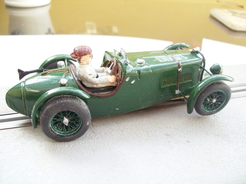

Hi Guys
Here is a little sports car I have just finished for an american client
It is a 1934 mg k3 magnette based on the very succesful 1933 k3 that won its class in the Mille Miglia and also the Tourist trophy.
The main visual difference is that the 1934 car had a boat tail which to my mind makes it a more attractive motor
The driver is supposed to be captain george etsron who actually drove the class winning mille miglia car
enjoy
Cheers tony

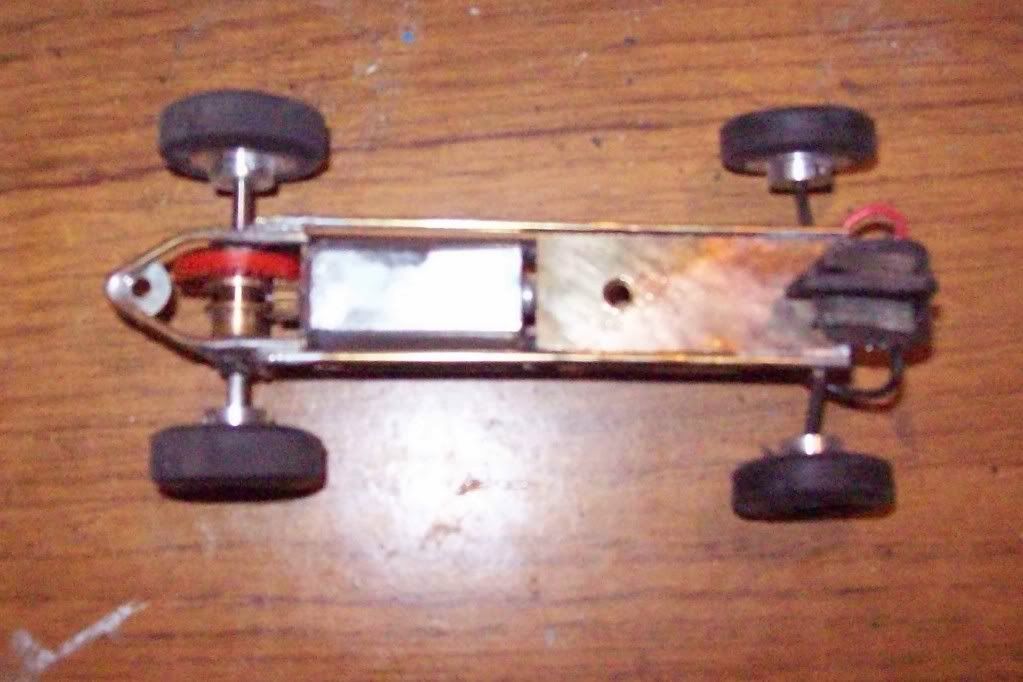

Hi Guys
As aresult of being asked by one or two of you about the chassis below is a picture of the underside
It really isn,t too remarkable ,it has a little brass axle bracket (not sure whose) to which the motor is attached this is then connected via an 18swg brassplate to the front axle by a couple of 16 SWG brass rails
the brass plate is only soldered to the rails at the front for about 15mm
this allows the frame to be quite flexy which is fine with the relatively low powered motor in the car
the guide is a slot it which had to be cut down in order to get under the front dumb iron apron
The front axle is a 16 swg piano wire cow horn type that i always think looks better on these prewar cars with beam axles
hope that is some help to you
cheers tony

Hi Danny
The shell on mine is one i moulded my self
it started life as a 1933 mgk3 airfix model ,but a friend of mine in the statesDan wilson) moulded a 1934 boat tail for the kit
All i did was fit the boat tail to the airfix kit and remould it
although the 34 wasn,t as successful it was certainly better looking and I think it became the standard for road going k3 in the mid 30s
It was also quite quick
