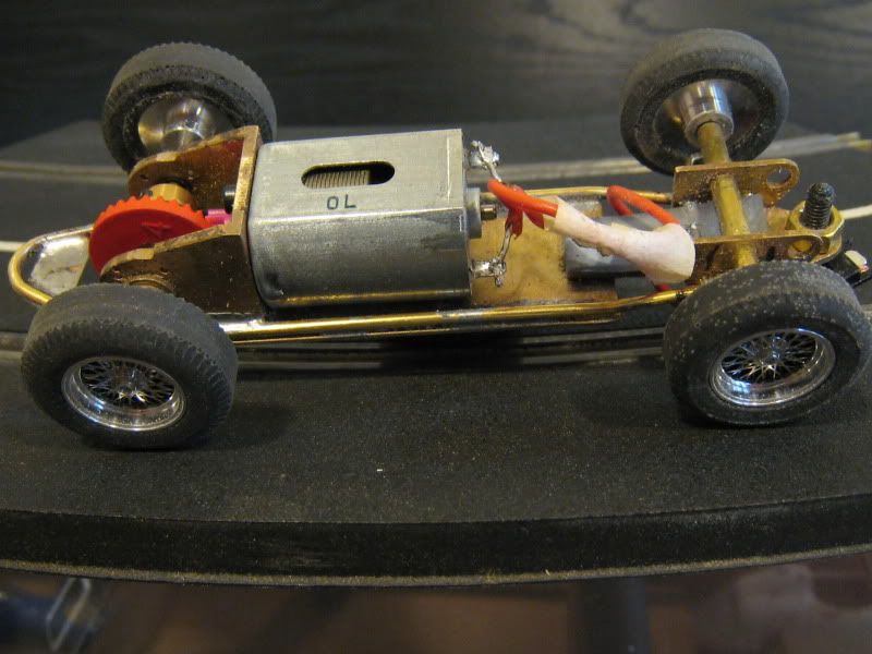

I should have posted this earlier and so now I will. This is one of two John Bacon Ferrari 246 F1's that are now in the works. This model will be the Mike Hawthorn #2 car. The other will be the clear scoop car driven by Masten Gregory. Chassis will be brass rod and the motors will be Fox, gears Slotit, wheels at this time are PP 16 in and tires are Ortmans--the ones run at Early Birds for the 60's F1 cars. Pictures show the start and where I am at now with the body about to prime for the first of many times I am sure!!!! The driver is fitted but Hawthorn's green jacket has yet to be formed and of course his visor is not in place as yet. The exhausts have been made and the larger end trumpets have been formed and will be primed with the car. As you can see the front suspension has been started and the rear leaf spring is todays project. The 2 cars will differ on both the front ans rear suspensions and I will post pictures of the second car when I start seriously on its construction. I would like to thank all those who responded to my post on 'Milliput" as to the filling of the large hole in the front nose area of the second car and I have chosen to line the interior with screening and fill with auto puty--so far so good and THANKS. Here are some pictures of the first car in the process and as always your opinions are appreciated

Looks a real racing car underneath, Howard. No transmission loss from a front-mounted motor.
