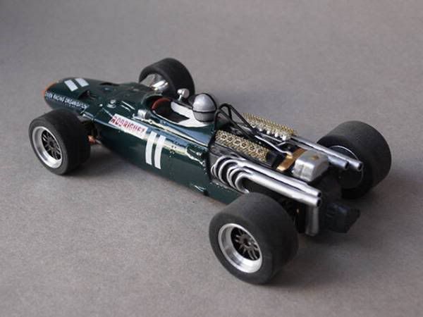

And here are pictures of the slot car. I haven't actually completely finished it as I still need to fit the body mounting post and the mirrors!! - Russell.
QUOTE (PastimeRaceway @ 2 Jul 2004, 00:35)How did you build the exhaust pipes?
Steve - I only painted the exhausts they are the original moulding of the wonderful Classic shells. I did actually add the intake trumpets other than that it's as bought. I know I keep banging on about them but these shells are just £5.50 and are superb, they open up so many model making opportunities for the slot car builder.
I trimmed the MRRC guide down a little to fit, fitted the body mounting post and the BRM has taken to the track for it's first run at Earls Hall Park and the motor popped out on the third lap...that's good old BRM for you. It's the first of my 60s F1's to have a mechanical glitch and it is the first of my chassis to rely on the motor being attached to the chassis rails, I reverted to my "belt and braces" approach and added the small mounts at either end of the motor and it seems ok now.
You will see in the photo that the car has tyre wear to front and rears just to prove I avoided the accidental tripod as patented by John and me. The car goes very well and is definitely my quickest F1 to date. The photo also shows it is now finished with the small windscreen deflector fitted.
