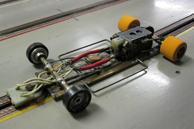

I'm simply the photographer here and Steve will have to answer any questions himself.
The orange rear tyres were simply on hand in my Formula 32 spares container and Steve tried them on for size. He attempted a lap or two of the North London track but although the car seemed to retain plenty of horsepower, the diameter of the rears was just too small.

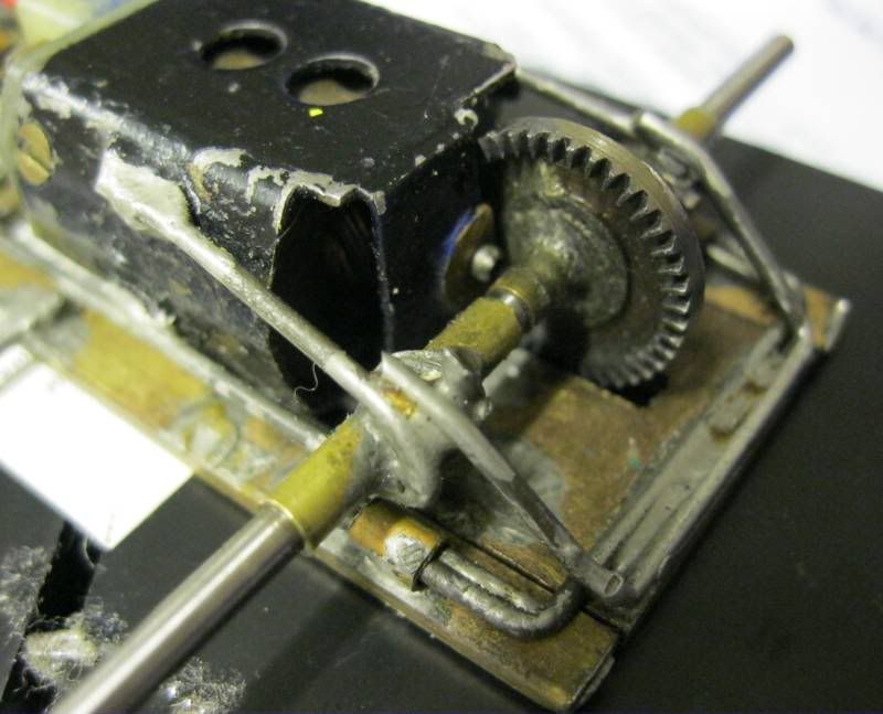

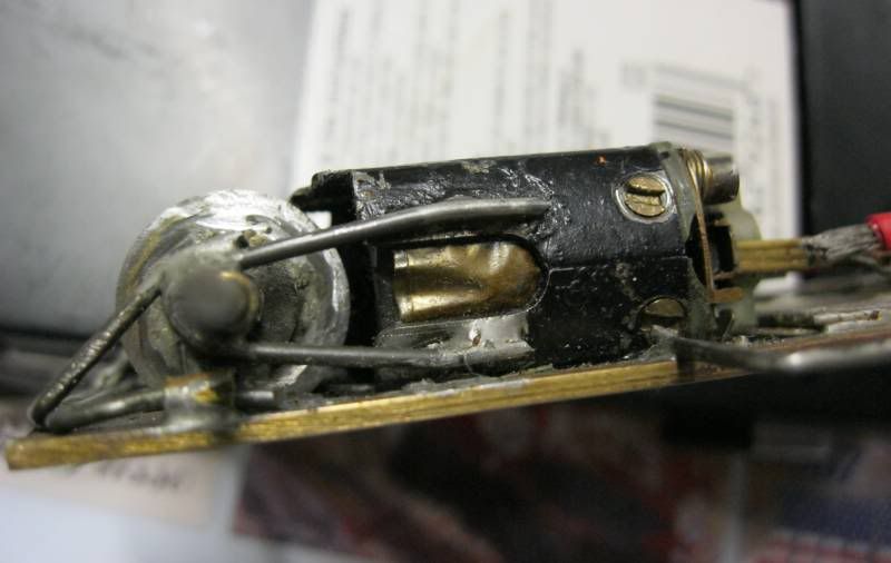

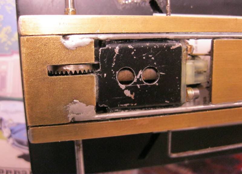

Detail pics.
I like the little dimple in the solder holding the rear 'U' piano wire brace where the builder held it in place with a screwdriver while he applied the iron.
Bus bars soldered directly to the brush hoods. Nice touch.

What I like is all the trouble the maker went to to shift the weight of the can back in the chassis, then covered the entire front end with lead.......

Beautiful work from Steve as ever.Note how he has "siamesed" the can cooling hole.If I remember rightly,PinC formula one chassis' also required surgery on the contrate to move the boss to the other side,at least until they were available commercially......the next step ,I think,was that everyone started to run a Tyrrell P34!
