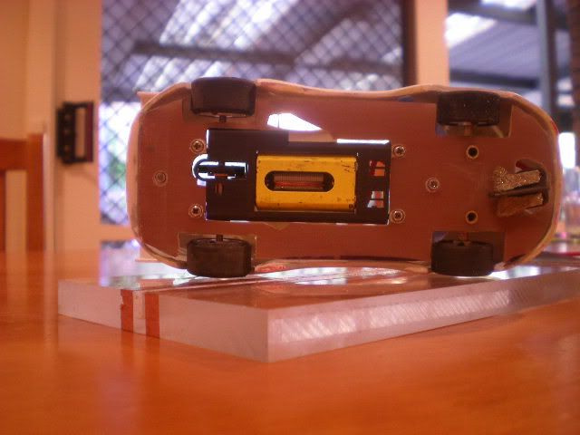

Hi I have a couple of these kits and love em
My 1st was a 240Z on a PCS 32 chassis
Actually only part way throught the 2nd one which is a Supra which has been pretty heavily modified
This one is on a PCB chassis with a Slot It Pod
I've also got a couple more waiting in the wings
Mike
84 Posts
If you are just starting the PCS is a good point
For me it gives reasonable performance with a little tuning
On the Supra and RX7 there is enough room at the rear (abit of hatch) to fit mounting posts to match up to the PCS chassis
For mounting posts I just used some sprue from the Arii kit Screwed onto the cahssis then cut to fit body at right height and glued in place while it was scewed to the chassis
