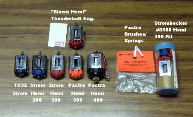

Some comparison "Hemi" shots and a TC32:
Large Hemi / Small Hemi:
and the two large Pactra versions together:
It would be interesting to know what the real difference is in these last two. Visually just looks like different color winds & endbells. The black has no cleaning hole, the red does. Same sticker, same gear, same can.
Years ago I bought 4 of those "Blown" Hemis (in the 1st photo) new in the boxes at a swap meet and they were always very slow and didn't even compare to the stock Hemi. Not sure what the problem is but, really not what they appear to be.

Thanks for the Hemi lesson Z - must admit I'd never noticed that STrombecker did both blue and red hemis, thought all the blueies were TC32s...
Not sure what the difference is between the two Pactra versions - and they also did a relatively rare 36D Hemi rewind, the Black Streak, with a black endbell...
Don, it seems that the one thing that was really lacking in those days was a melt proof endbell and it's still a problem today building these vintage motors especially if you want to venture into 26d or 36d. The black Tradeships Roger sells are much better but, as I proved at the beginning of the Sunchaser series, those too will melt (if you have a shorted arm as I did.)
I guess we now have more knowledge as to what to do to prevent it but, is there a "bolt-in" remedy available? I haven't seen anything yet that meets the requirements of a vintage series other than good 'ole scratching of the parts needed, which isn't so bad I guess if you have the time & know how.

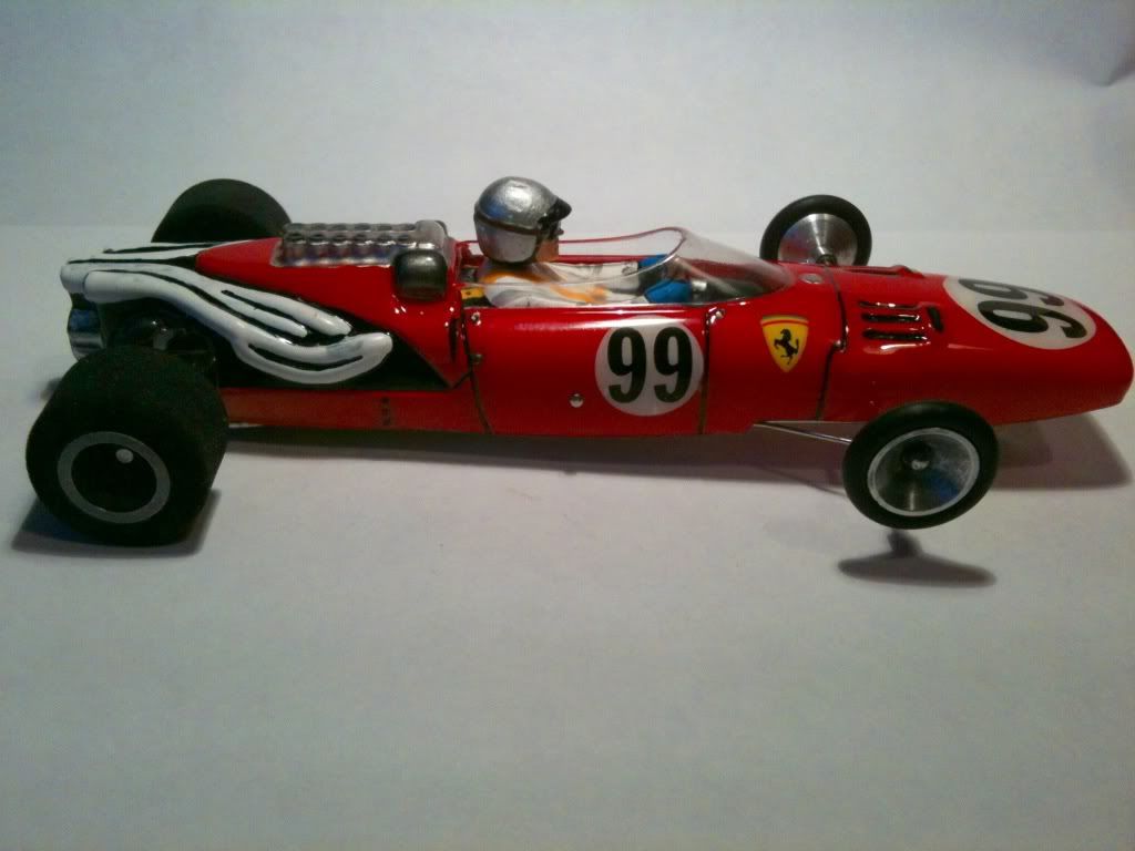

My first picture posting in a very long time, help!
Think the first is a near copy of a Champion 66 Ferrari RTR.

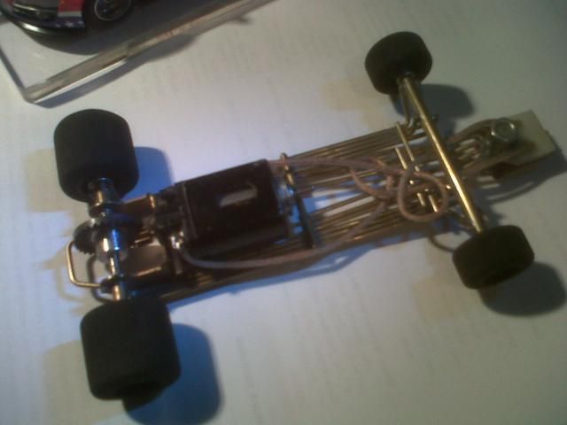

A Black Widow chassis minus a motor, got a feeling it works better this way!

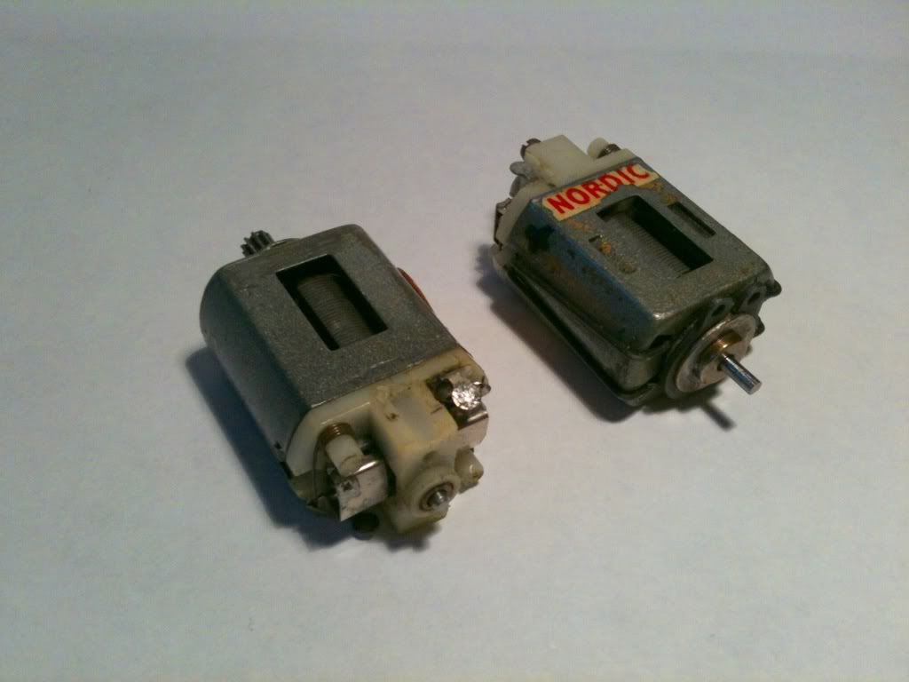

A pair of well used Nordic Gold Star motors, affordable rewinds from my youth.
Thanks John, always glad to see you posting!
Nice to see the Nordic motors, since I just picked up a couple well used versions. Were they just rewound, or did they have heavy-duty mags, etc.? I see the can clips made it over to your side of the pond too! How did they run compared to a Champion say? (speaking of which, nice Orange Picker - can I have it? )
You're right, the Black Widow probably runs better with only one motor, but it looks kind of naked like that... Is that your own rewind?
And yes, the Champion Ferrari really looks like an original! I think this was supposed to be about the fastest RTR car of the time, but it also cost something like $19.95, which was many weeks and months of pocket money for us kids... Still, compared to $15 for a Manta Ray, not that expensive...

Hi Don
Nordic produced two motors, the Silver Star was intended for low power tracks and the Gold Star for use on the raceways.
I have been told that they were the work of a local racer [to Nordics in Southall West London] called Wally Pooley, think that's how you spell it!
These were stripped down Mabuchi 16d, in the case of the Gold Star the can was painted gold and the armature rewound, epoxied and balanced, probably static balancing but all the rest was standard.
As far as I can tell the magnets were standard Mabuchi's but a Mk2 version was later sold which had the Hitachi Rikochet magnets fitted [glued in], at the time these were considered to be superior to the standard Mabuchi magnets, they certainly clonked more than the Mabuchi's but not sure they were actually any better!
Have no idea what the wind was but I would think it's along the line's of 60+ turns of approx 32 swg, never been able to take one apart to find out due to the quite heavy epoxy.
Not in the same class as the Mura's and Champion of the time but quite a bit cheaper and don't forget that not all raceway goers were pro racers, most were just kids wanting to get there Riko kit to go faster than his mate's so these motors were cheap and more than capable.
Yes the Black Widow is a rewind, had a small spool of Simco wire so did it 60 turns of 30awg, also installed period after market 16d mags but have a feeling this might be a little too hot in this chassis!
