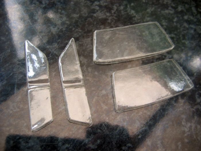

Cheers John, yes it did. Don't have a picture of if right now but they are vac formed seperate pieces.

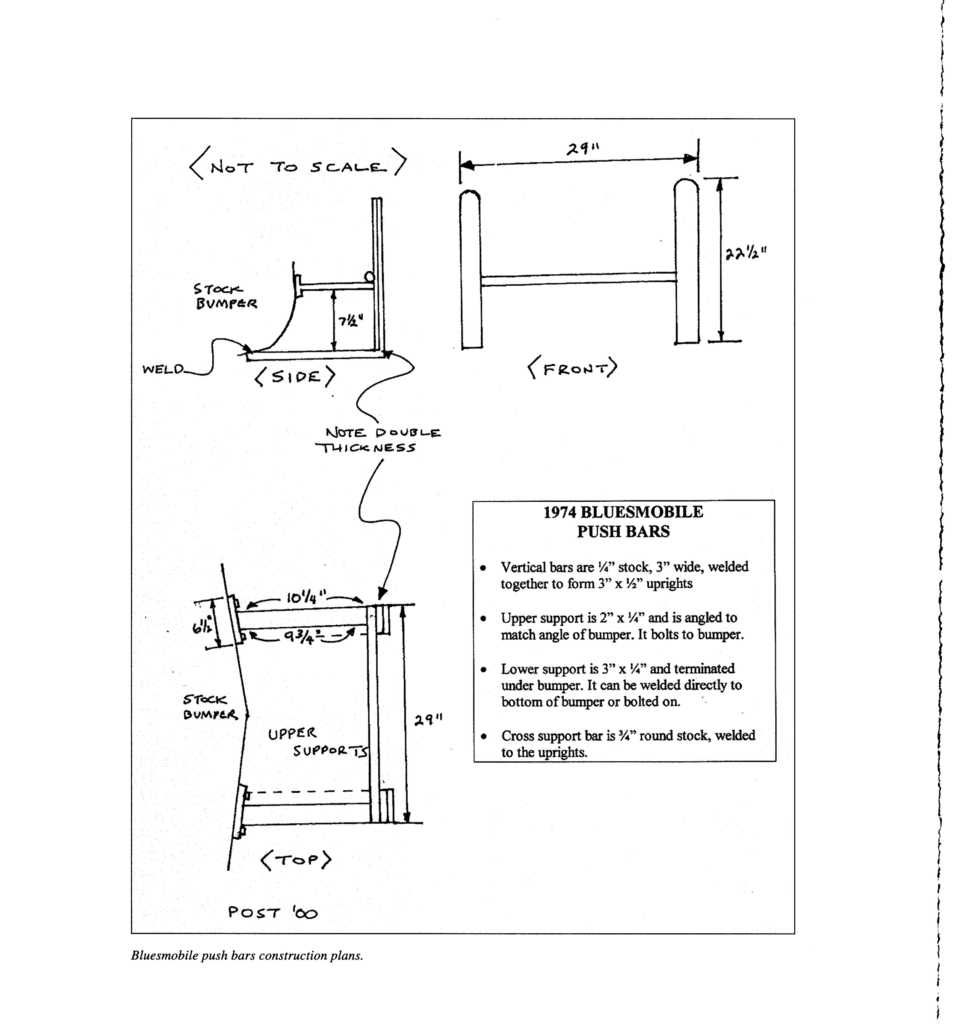

. Does anyone know if there should be a horizontal bar joining the the two uprights?

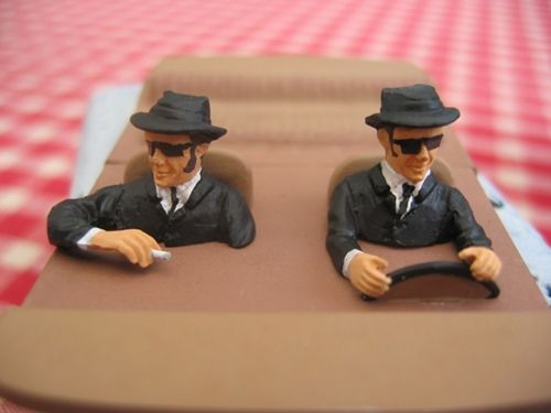

Hi Martin, the figures were made using the kit heads, a couple 30's driver figure bodies and shaved the the top pockets off to look like a jacket and some airfix army figure arms, all bits that were in my bit's box! more pictures to follow as the dirtying up is done and livery on!
So here's a few more pics now I've finish the bodywork. First John asked about the glass, here it is...
I didn't use it as I'd filed out the windows before checking the fit so made my own
For Martin here's a close up of the interior, still a bit to do on this...

PS. thanks for the info on the push bar, I re-made mine to look more like the real thing.
Thanks for kind words, yep Belushi is the shorter, just need to add sideburns and sunglasses
