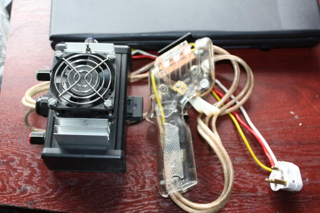

Hi, I have just bought this.
It works, bought it SH, with a 32 race car, £60. Used it on a wooden track with this type of SC car
At this track
Netley MCRC
Another photo on the Controller
Question. The knobs....Is it just a case of playing and seeing what drives best, or is there a way of setting them, in other words, how do they work?
TIA. Andy
Hi Andy
On most controllers the 3 knobs are sensitivity, brakes and choke
Sensitivity adjusts much power power you get when the trigger is part way down. This is used to make the car easier to drive round corners. It makes no differance to full power or brakes. If the car feels like it's sluggish in corners turn this up, if the car seems to have too much power in corners turn it down.
Brake adjust how hard the car brakes. If the car feels like it's topping too quickly into corners turn this down, if the car won't stop quickly enough going into corners turn it up. It makes no differance to full power or sensitivity.
Choke usually reduces acceleration out of corners, which can make the car easier to drive. If you have too much power comimg out of corners making the car unstable, turn in some more choke. It makes no differance to brakes.
I'm not going to guess which knob is which on that controller.
Adjust them to suit your car and your driving.

QUOTE (Gone Racin @ 2 Apr 2010, 13:06) <{POST_SNAPBACK}>Hi Andy
Sensitivity adjusts much power you get when the trigger is part way down. This is used to make the car easier to drive round corners. It makes no difference to full power or brakes. If the car feels like it's sluggish in corners turn this up, if the car seems to have too much power in corners turn it down.
Brake adjust how hard the car brakes. If the car feels like its topping too quickly into corners turn this down, if the car won't stop quickly enough going into corners turn it up. It makes no difference to full power or sensitivity.
Choke usually reduces acceleration out of corners, which can make the car easier to drive. If you have too much power coming out of corners making the car unstable, turn in some more choke. It makes no difference to brakes.
Very helpful GR, thank you. I now have a clearer idea on how things work.
