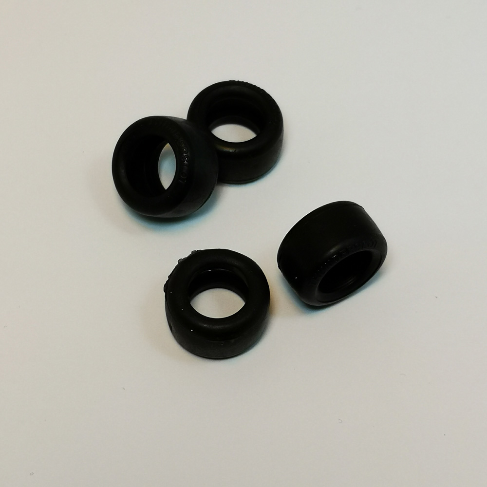

#26 ·
The NO grip Thunderslot tires were originally black. Here’s a set that I mounted up and trued lightly. They are extremely sticky but not like the old NSR extremes and have not balled up.
Thanks, Tony.
#29 ·
The NO grip Thunderslot tires were originally black. Here’s a set that I mounted up and trued lightly. I was still an infant when I was learning how to true tires so please don’t knock the look, they actually work. I just wanted to show, yes there were black ones available at some point.
What tyres are on the rear?
