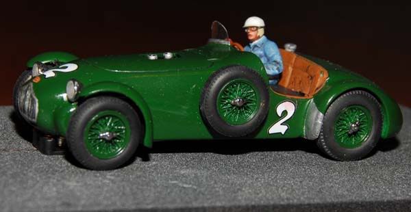

I've used Tamiya Military figures as well. These are easily modified to suit most purposes.
I've also used MRRC drivers and whatever comes to hand.
in this case I used the driver that came with the Revellogram `Vett but replaced the driver's face with an MRRC spectator's face.
One of my favorites is the Lemans Miniatures full figure driver. The realism is striking
In this case I just used the head which transforms the as issued driver in this Pioneer Mustang.
In another instance I used the LM body and borrowed the head from a newer Fly driver to represent the current vintage race driver.
IMHO one of the best out there for early post war cars is Proto's driver figure. It's just the head and shoulders but what's there is phenomenal
Greenman62

QUOTE greenman62 slotcars are real looking cars because of the perfect built AND best driver figurines!
Thank you! Part of the enjoyment of slot racing for me is the "moment of suspended disbelief"... when the "toy" car on the track becomes real in my mind. That's why I try so hard to make the cars as realistic as I can.
