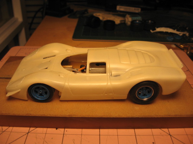

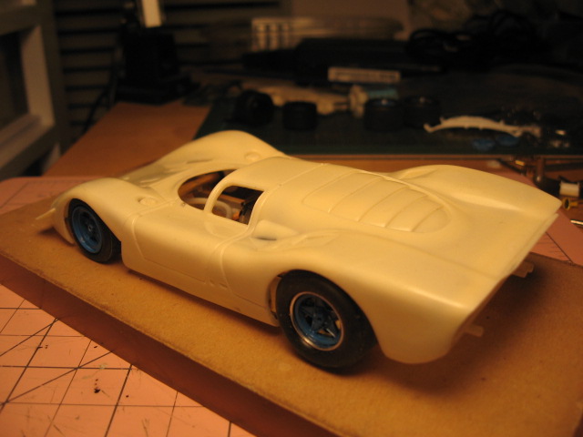

I never get tired of building Ferrari 312 P coupes, this being my fifth. I like trying different motors and layout so this'll be an inline slimline motor for our club's Speedway 95' track with a 20 foot main straightaway and banked corner.

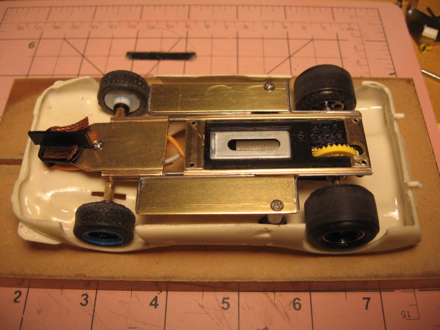

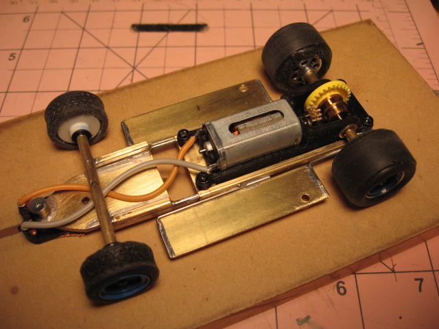

Starting off with my tried and true adjust-o-wheelbase inline motor chassis.
The usual components were gathered and include,
  • main rails and front axle tube support- 3/32" square brass tube
  • guide tongue - .062" x 3/4" brass strip
  • guide tube - 5/32" brass tube bored with 9/64" bit to accept Slot Plus Universal 7mm deep guide
  • guide tongue sliders - 1/16" piano wire
  • motor pod support cross members - .062" x 1/4" brass strip
  • front axle tube - 1/8" brass tube
  • side pans - .032" x 1/2" brass strip
  • side pan flex supports - .032" piano wire
  • motor pod - my own 3D printed slimline pod with Parma/Champion 3/32" x 3/16" axle oilites glued and epoxied in
Drive train includes,
  • Professor Motor PMTR 1532 slimline motor, FK050, 35K
  • Slot It 10t pinion and 28t crown gears
  • All Slot F1 rear rims with my own cast urethane tires
  • Slot It 15.8 x 8 plastic rims and urethane copies of the Scalextric Caterham front tires
Heard about the motor from chrisguyw and was curious that it has neo magnets with good braking characteristics.
H

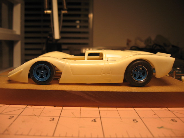

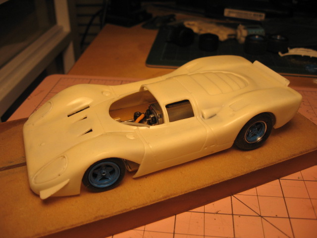

Mounted the resin body, tri-post, my usual practice.
Got the body low.
Weighs in at 87 grams and after painting and installing the vac-formed windscreen and interior driver tray, it'll be over 90.
Hope it performs well on the club's Tanex speedway track.
Dan

Cosmetics done.
I'm liking Ferraris in yellow these days, so sprayed Tamiya TS-16 Yellow over Tamiya white primer followed by brush details in flat black, flat aluminum and gray and protected with semi-gloss clear. Wheel inserts contrast in Tamiya brush painted X-14 Sky Blue acrylic.
Glued in my so-so vac-formed windscreen that's good enough for me.
My driver figure's going to need trimming to clear the motor.
Fabricated exhaust pipes with 3/32" aluminum tubing, painted white, and conveniently joined to the 3/32" square brass chassis main rails with 1/16" piano wire.
Will test performance on the Tanex Speedway club track with urethane and rubber tires next week.
Dan

Did some incremental changes and glad to say that I got improvement in my fastest lap.
Incorporated adjustable motor pod movement with M2 nyloc nuts and bolts cushioned by urethane and metal spacers. Yielded a slight improvement from 7.328 to 7.283 seconds.
Then replaced the 28t Slot It crown gear with a 30t one for a 3:1 gear ratio and setting my Slot It controller for maximum braking. Got a real improvement of just over 2/10s with a 7.075 fastest lap.
Pretty pleased with the results.
Next up will be changing to treated rubber tires, either NSR or Scale Auto.
Dan

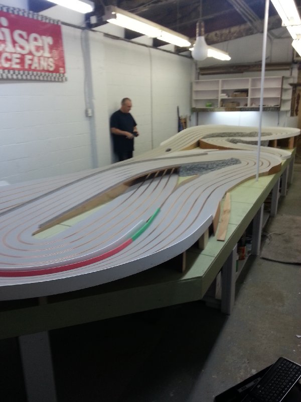

As for testing, I've lost access to Tanex Speedway till the fall, but I still wanted to see if there was difference using treated and trued Scale Auto AS25 rubber tires.
The new test track's my own in-progress Land & Sea themed layout. It's quite different from Tanex being tight and twisty with hillclimb-like elevation changes.
With urethanes, I got a fastest lap of 5.65 seconds. The rubbers yielded a slight improvement to 5.60. Not really that much but I think the improvement on the bigger Tanex would have been more significant.
Dan
