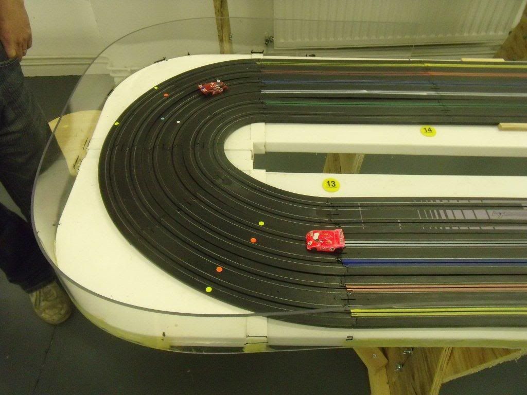

As there has never been a large permanent HO track in the UK until now there has also never been the need to think about how to divide the track up.
With the HONK track last autumn (and again for the HOGP on the 29th of this month) we simply extended our usual practice of placing the temporary markers alongside the track to 100 such markers instead of 20:
(Image shows 13/100th and 14/100ths)
Longer term I would like to do something better. The options seem to be:
Measuring one lane (a middle one?) and marking the track at those points
Marking each lane individually
Footages
Not really sure how the last one works, but could those with experience of the above comment on the pros and cons please?

Thanks. One method is a lot more work of course.
It did occur to me a hybrid method might work, in other words 10%, 20% etc of the track would be marked off the quick and dirty way, with the 9 sections in between being done accurately.
One thing I have found interesting is that I was told that, in HO at least, any track without bridges will have a total difference from one lane to the next of just over 239mm, regardless of layout. Software for track planning seems to back this, so when people talk of lanes being different by 10' or more I wonder how they come up with that.
Any comments on footages? Do these use sensors around the track?
