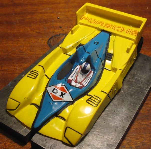

Below is my effort, not the greatest paint job but the bodies seem to have a short life as this one is torn already from progressing up the learning curve, and I have a new and hopefully better painted shell on the way.

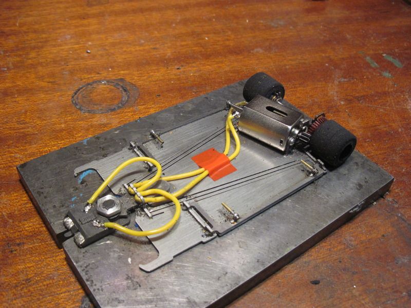

The cars run a Falcon @48K rpm motor, in a laser cut stainless steel chassis with sponge slick tyres and so will run faster and handle better than standard hard bodied cars due to the low C of G, and the chassis dynamics my chassis shown below.
IMG_1558_zps5s6bguga.jpg?t=1497107136
Chassis pic
There is an excellent PDF file on the BSCRA site on how to build a Genesis so I will skip the build details and just add a few personal observations.
· Be careful soldering the rear bearings to the chassis hoops as the solder can wick to the axle holes, keep the axle in and well oiled, aids alignment, keeps solder out.
· The kits may not have sufficient washers to set the front guide up correctly but any suitable flat washer can be used to get the ride height correct.
· Avoid splaying the braid out too much as it can lead to the guide rising out of the slot by riding up the track braid slot walls
· Rear tyres will need to be ground down to lower the ground clearance and improve handling, recommended height under the chassis at the motor is 0.6mm. I have managed to do this with the tyres mounted on the car using a flat steel plate, coarse grade sandpaper and an adjustable power supply to keep the voltage low.
· Body shell is supplied with re-enforcing tape for the fixing pin body shell holes, other tapes I.e. electrical also work and is recommended to avoid tearing
· Mount the body shell such that there is a gap between the motor and the body shell to allow the side pans to freely move and is trimmed following the chassis line such that the chassis skids hit the track first not the body shell.
· Body pins need to have a slight curve bent into them so that they are a force fit into the chassis tubes otherwise they will fall out.
The vac form body shell can be painted with acrylic paints either by brush or spray can/air brush but is painted inside out so work out the order of painting first. Tamiya, Halfords or specific paint for lexan ( I.e. for RC car bodyshells) is used not forgetting to wash the bodyshell in soapy water first otherwise the paint will flake off in use. Note I found it easier to paint the driver on the outside of the shell as easier to determine the detail.
The Falcon motor current requirements are similar to the NSR 38K boxer motors both take @30 watts of power loaded (Source Slotcar News motor list) so electronic controllers used for hard bodied will work but will run hotter than say running 23K Slot-It FC130 motors. (Note have measured @16A+ peak under acceleration for the Falcon. )
Standard resistor controllers and resistors I.e. 35-55 ohms used for hard bodied cars will be too sluggish to control as the Falcon motor pulls 2-8 times the current compared to hard bodied motors, so a low ohmage (15 ohms) or electronic controller is advisable.
Note: All controllers should have either an inline fuse or a protective cut out as the club power supply is rated at 600 amps and although each lane is fused down to 30A this is more than sufficient to fry any leads, transistors or controller resistors in hard bodied controllers with ease before the lane protection cuts in.
On the track, those of us new to this racing and using our hard bodied electronic controllers found that dialling back the sensitivity helps with controlling the power and reducing brakes helps with obtaining a sooth flowing pace around the track. From the limited racing so far apparent that the cars are fairly well matched and that driving errors for the newbies were losing races rather than outright speed to win. The track has a technical section furthest away from the drivers stand so a lot of practice needed here to get a smooth transition.
