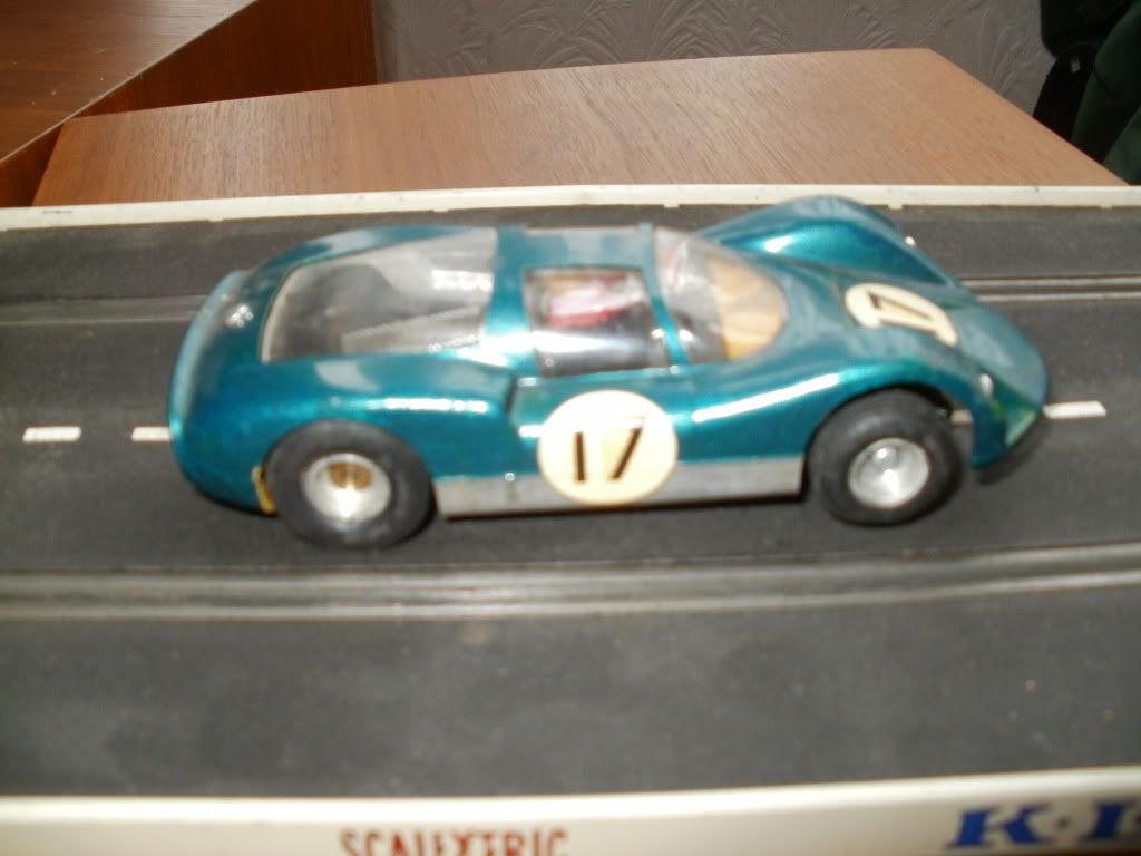

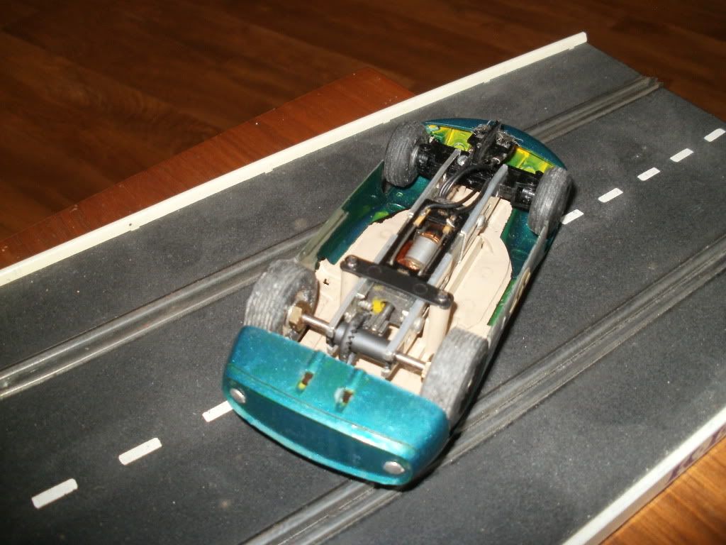

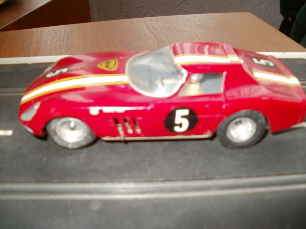

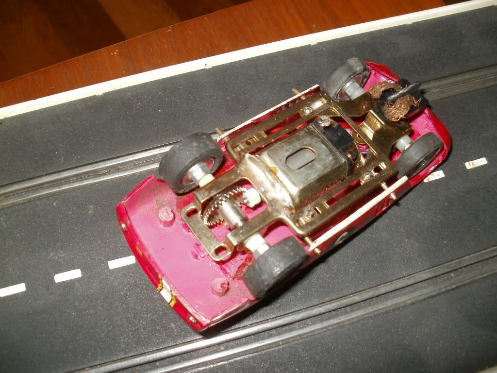

I'm more of a RTR man but I just aquired these and would be grateful for any info on them . Advance apologies for the poor quality pics , but I bounced the camera & it don't work so good now .

The first one is a Monogram Ferrari GTO LM/64 body fitted with what looks like a Riko ( Monogram copy ) brass chassis with riko running gear. the body mounts are spectacularly bad!
The second car is an Airfix slim line motor/steering unit in a matching Airfix Porsche 906 bodyshell.
I like the Airfix cars but you can probably get the riko to go a damn sight faster...

The Ferrari looks like an old PARMA chassis to me.
Not that it matters either way the advice is still valid.

I don't think it is a Monogram Ferrari. The cut off rear body mounts are in the wrong place. It may be a Palmer kit (as opposed to a PARMA chassis, Ian). The chassis looks Riko, but the motor looks too chunky and is certainly not the earlier Rikochet motor. The Porsche906 Airfix clubman chassis motor looks in good nick.

QUOTE I don't think it is a Monogram Ferrari. The cut off rear body mounts are in the wrong place
I have just taken a look at my Monogram GTO and yes, the body mounts are wrong on this one so 'dunno guv' it could be any one of many, it was a popular car back in the day...
As to the motor, the later Riko chassis were sent out with a rather potent ballraced 16D rather than a Rikochet MK1 or MK2 (MK2 was a rubbish motor).
So I still rekon this is a Riko chassis and running gear.

It's a normal Riko adjustable 'Monogram Ripoff' chassis with the later Rikowhip (ballrace 16D) motor, absolutely standard apart from the Scalextric pinion, doubt that meshes very well!
Body is the Palmer 'Monogram Ripoff' 250 GTO LM!

The Ferrari's chassis and running gear may be from a Riko GXL kit, the later version of the Competition series as described in a recent Riko thread here in the Vintage forum. The GXLs had a can-end-drive 16D motor like this. It was named as the RikoRocket in a couple of posts and images.
The kit came with L-shaped side-pieces for body mounting, which aren't used here, but perhaps they would have been too wide.
Geoff: The crown gear looks like the kit's original pressed-steel contrate, which chewed up even brass pinions, and would be worth replacing ASAP.
