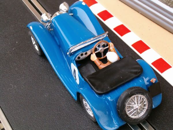

This is the finished car, which as you can see is finished in a tasteful shade of blue, which is meant to represent Air Force Blue. I had more trouble with the paint I used on this car than with any other part. All entirely my fault.
I found some spray cans in my local Halfords store, Plasticote Fast Dry Enamel, and loved the colour. In truth this paint took seven days to dry between coats. I would not like to hazard a guess how long their ordinary enamel takes to dry!.
This view from the rear of the car shows the cockpit area. I constructed the false floor and rear bulkhead from clear acrylic material that comes with new shirts when you buy them. Don't throw anything away!. The driver is the "co-pilot" from the Carrera Aston, but he has had drastic surgery preformed with a Dremmel, i.e shortened arms and most of his lower torso removed. He looks a little stunted so I may have gone a little overboard with the cutting and slicing.
