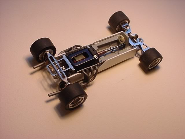

Thanks to Russell's inspiration and help I've made progress on my entry for the F-1 race. Just like the original it's complicated as hell.
It started as a Classic shell...then the nose was rebuilt to incorporate a scale radiator vent, OK so I went this far and decided to create the tube and upper body like the real thing, this left an opportunity to include a scale interior.
The rear wing is modeled after the late season car, cantelevered out using carbon fibre wing supports, and the front are adjustable again modeled around a carbon fibre spar.
Next to be done is the top on the engine, windshield, dash wires, and oil cooler.
It's four wheel drive with a Scale auto can, squat ball bearings and epoxied and balanced slot-it arm.
If time allows the motor will be lightened considerably.
Chris
Beardog Racing

Omigosh! That's beeuteeeeful, Chris!
Why no strap motor, though?

Chris very kindly sent me some pictures of the chassis of his Lotus 63. The design, craftsmanship and execution is simply outstanding -- too beautiful not to share!
