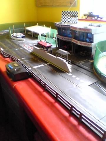

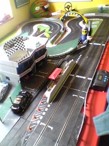

I'm am looking for some low level lighting for my pits and pitlane and came up with the idea of having some LED's wired in parallel. I have two purely scenic pit garages and I'm thinking of 6 lights, one in each garage, one over each pit area in front of the garage and one each in the pit wall awnings. All I want is low level lighting as my track isn't too huge so lights that are too powerful would light up other parts of the track which I want to keep dark.
So my questions are:
1) Are LED's going to provide enough light, I think they will judging by the light emmitted form LED's used as headlights?
2) Is it best to wire in parallel so if one light goes the others will still work?
3) what kind of power source will they use? Will a battery or two be enough? or should I wire it up to something more substantial?
4) Can you get white LED's?
If it works out well I might well end up lighting my paddock in a similar fashion.
Here's a couple of pics of my pit area to give you an idea of what it looks like.
Thanks for any help you can offer.
