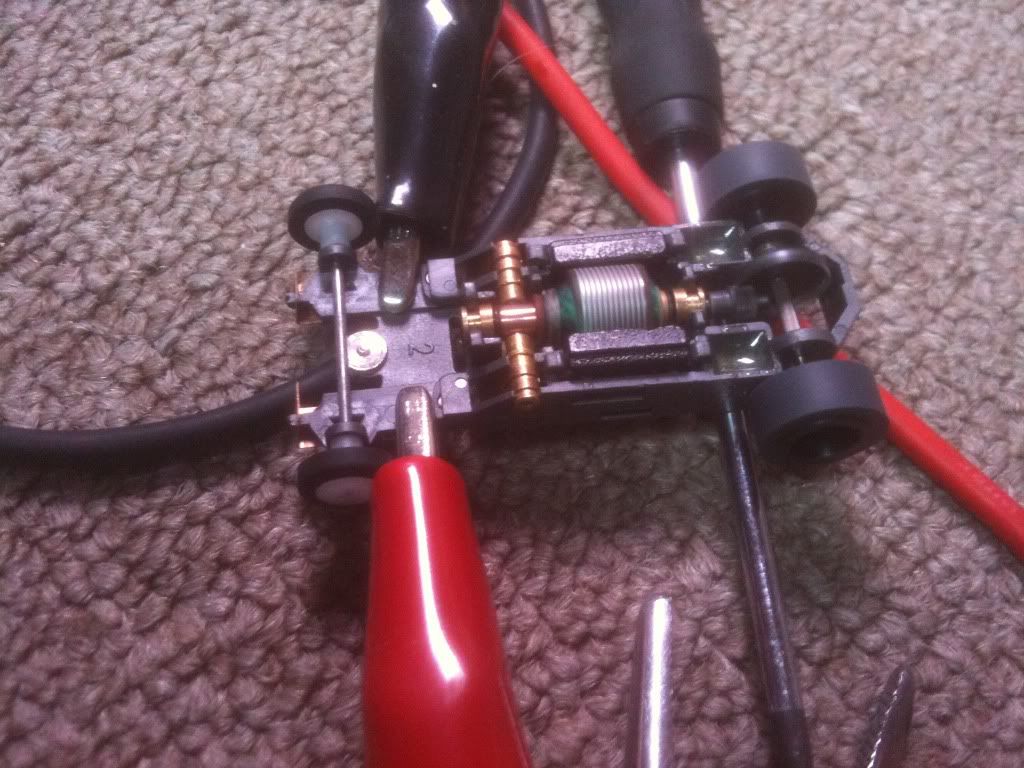

some pics of mine when i was running it in

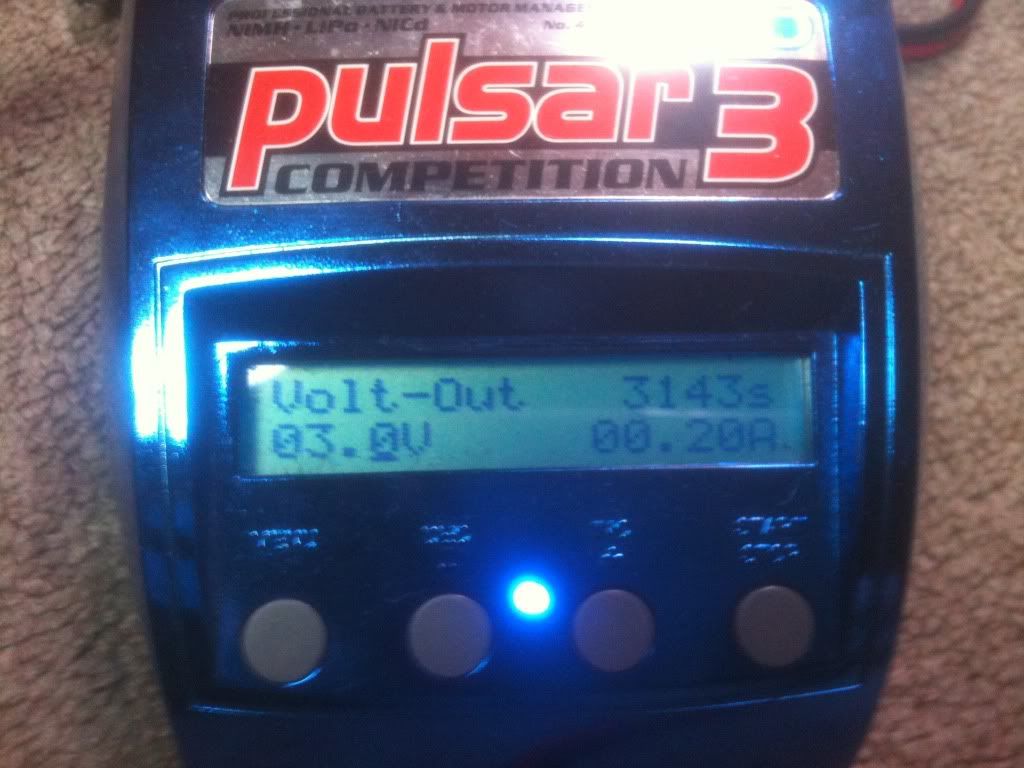

and what i use to run it in it is a lrp comp 3 rc car battery charger
it has a option so it can run solder iron lights and laves so i can set it from 0 to 12v
and it will also tell you the amps that are being pulled from what ever it is attached to it
i will add a pic of the under side of the mega g tomorrow
it has a 3.5ohm arm in it and i have flush mounted the stock neo mags

I will have some more pics up of mine later mi e has Bsrt axl 300 double flang hubs with 474 hard Bsrt tyres and a tyco pinion and tyco crown gear . It has a stock wizard front end and a wizard 3.5 ohm arm in it I to was suffering with heat problums it terns out it was the gear mesh it felt ok but it was a fraction to tight so out with the axl agan I got some sand paper and sanded down the back of the crown gear put back in sorted it naw is only at 0.17A at 3.5v wene I was runing it back in the first time I did it it was at 0.28 at 3.5A so I am prity shour it is sorted now can't what to test it agan it should be very fast
