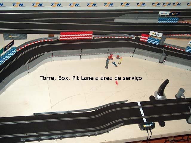

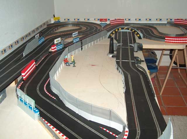

I finished the first stage yesterday. The original project had some changes, but I like this. Now the track increase and has 15.02 meters or 49.56 foot, and has 2 closed bend, one before finish line and other before start the straight sequence. I think that new route is more technical and faster. I wait until next week to take the track onto wood. I get suggestion.
172 Posts
Thanks a lot everybody. I finished the first stage. I've tested some border, fences, scapes areas and accessories made by ninco, scx and scalextric. The ninco has the "wall" as like nascar tracks and I like it. The scx has the customize bridge. The border made by scx hold better in track than scalextric and I didn't use the clip but the fence is red and border is green
. I need to build a banked curve, because I tested the scx and scalextric, but it were bad, I'll made on wood.
Well, I know that my track need some things (tower, box, pit lane, etc. etc), and I'll build slow, bit a bit.

Track Sections Info
C8236 Short Straight 2
C8200 Quarter Straight 2
C8207 Half Straight 6
C8205 Straight 19
C8246a Start Side Swipe straight 1
C8246b End Side Swipe straight 1
C8202 Inner Curve R1 7
C8206 Standard Curve R2 17
C8234 Half standard Curve R2 4
C8204 Outer Curve R3 2
C8215 Lapcounter system 1
C8217 Power and Control 1
C8295 Elevated Track 2
Track Lengths
Track Lane 1 Lane 2
1 15.27 m 15.27 m
The track at photo
One good choice is put a "gincane" after bridge.
