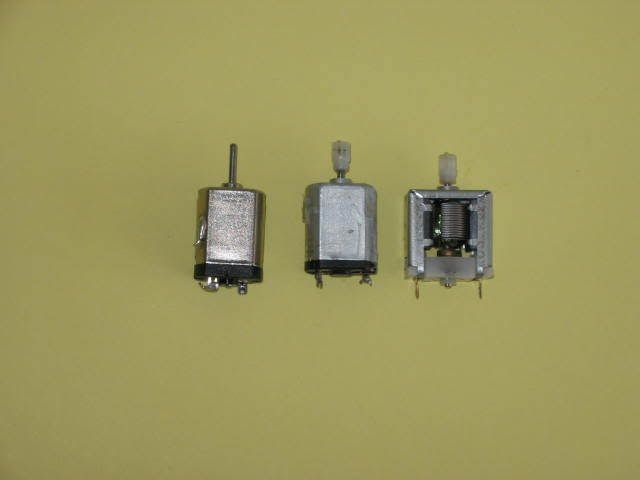

My first attempt was the motor shown here on the right. Much smaller thatn the GO! on the left. Neos. Arm shaft 1 mm.
But : Its voltage range is between 5 volts and 12 volts on the data sheet, and in reality the motor starts running at 7 volts. The power is too low.
In my opinion it should be possible to get a usable motor from this basis. Probably a matter of winds / wire dia.
But how to find out ? Pre - finance some experimental changes with the producer ? They even wanted 40$ for the five samples...
Well, come on, what "tiny" motors do you have ?

Predominately, I use 2 types of FF-030 cans and the "boxer type HO motors. The "boxer works great for open cockpit cars.
The left one is the GO!!!/SCX Compact/Radio Shack/SCE motor which snap into the GO!!!/SCX Compact chassis, the center FF-030 is one available through electric supply stores, and the "boxer" is on some 1/43d scale retailers websites.
