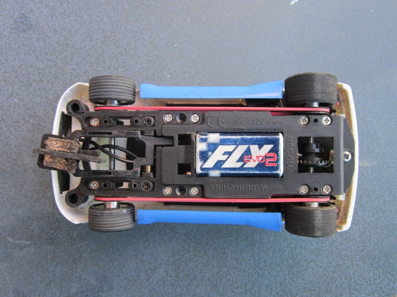

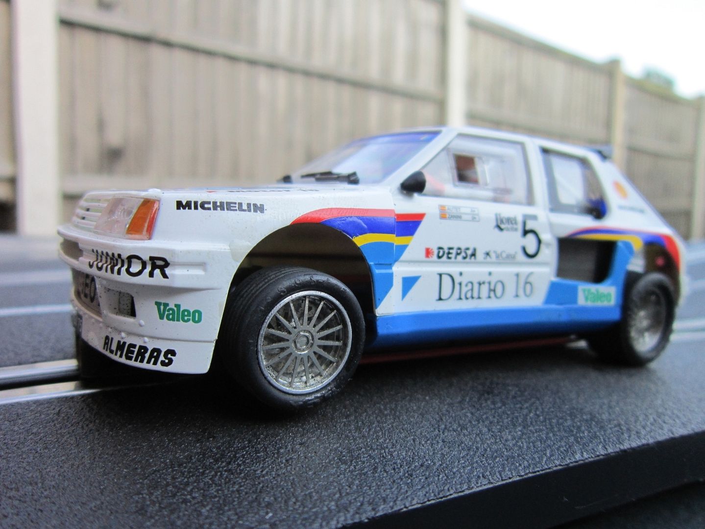

As mentioned elsewhere I picked up a Spirit 205 T16 body up at Ossett swapmeet a few weeks ago, and after much consideration I eventually decided to go for the MSC chassis, at a little over £11 I thought it would be a good buy.
I hadn't planned on using a drop arm but without the shortest drop arm the chassis wouldn't fit under the body, and even then it is only marginal

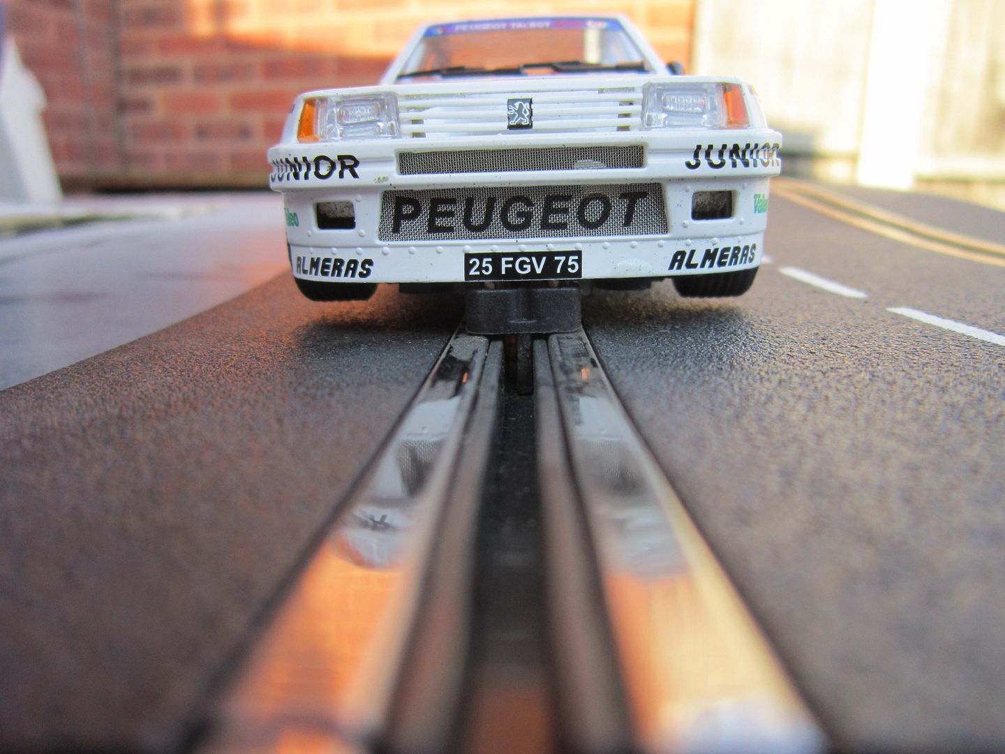

This picture shows how close to the front the guide is, you can also see the plastic added to which I screw the body too
Another view showing how near to the front of the car the guide is

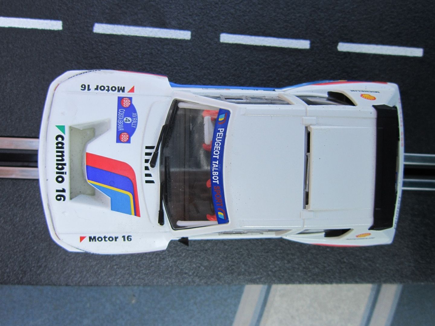

It can't be viewed from above though
I even had to trim the rear of the chassis for it to fit
The completed car
It's just had a few laps and feels OK, although the motor doesn't seem as punchy as it did when I ran it in the Fly. Probably need to do some experimenting with different tyre combos as the back is a bit slippy

I know this may seem a daft question but what is the point of having four wheel drive if the front wheels don't touch the track as in the picture.
612 Posts
Discussion Starter · #3 ·
They do touch on most of the track, but plastic track isn't exactly as flat at it could do
And they definitely touch in the corners

The fly motor probably feels slower due to losses from the extra friction created by the 4wd.
I got my body lower on the chassis by modifying the rear of the chassis- I cut the rear bit off and added a new one about 1-2mm lower down and this makes the body height looks good still got to sort some correct wheels though
