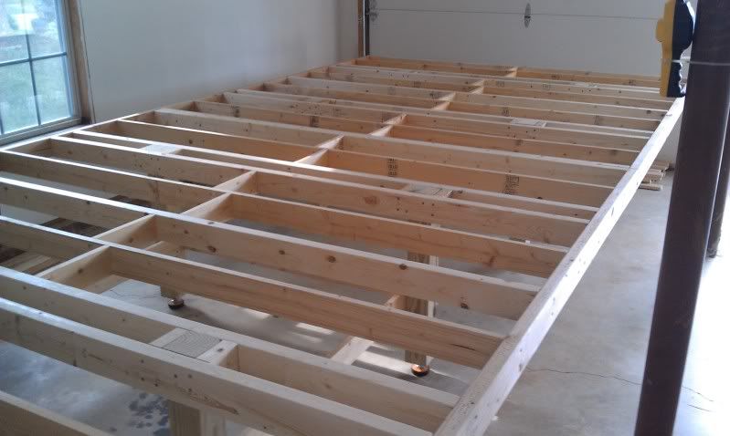

Some of you may have seen the pictures of the demise of my first track,
I am happy to say no one was hurt and building of the second track has begun,
This one will be a little smaller 16'x8' instead of the 20'x9' of the previous one,

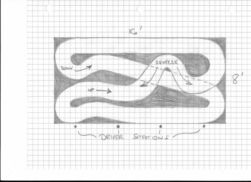

Progress has moved along fairly well as the table is finished and just need to get a pickup and get some MDF and the routing will commence(once I decide on a design).
This is the design I'm leaning towards, It's roughly 67' running length.
This one is stationary no up and down and you can get all the way around it. I made it a little lower than the previous one so my 4yr old can get the cars a little easier.
Jim

524 Posts
Nice workmanship Jim, the frame looks very strong. Not many builders take time to build a solid frame for a wood track, but it is important like the foundations of a house. Good idea having access all the way around the track, great for marshalling.
Layout looks great, are you running 24 & 32 scale?
I look forward to seeing your track progress.
- Cam
173 Posts
Cam,
32 is what we normally run but we should be able to run some 24 stuff.
Jim

173 Posts
short update, got the rest of the squeeze section routed and supported,
Kind of wish I would've made the lanes in the squeeze a little closer and made the squeeze longer.
Well now it's on to fixing the minor mistakes, painting and the copper tape.
Jim

212 Posts
Looks Great Jim!!
What paint colour / brand did yous use?
Also noted that you have used some feet at the bottom of the wooden legs for the frame - are these adjustable and did you do that specifically to ensure the track was level?
173 Posts
Discussion Starter · #14 ·
QUOTE (MrFlippant @ 5 Dec 2011, 20:21) <{POST_SNAPBACK}>Looks good.
Is the overpass loose so that you can easily tape under it before securing and taping it?
Greg, no the overpass isn't attached yet just put it up there for pictures
QUOTE (90s F1 Kid @ 5 Dec 2011, 21:24) <{POST_SNAPBACK}>Looks Great Jim!!
The paint is Glidden Matte gray I got from Home Depot off there oops shelf. I did not do the feet just for the ability for leveling, it was mainly to keep the track from moving. They are rubber feet and on smooth concrete the wood tends to slide easily.
Jim
