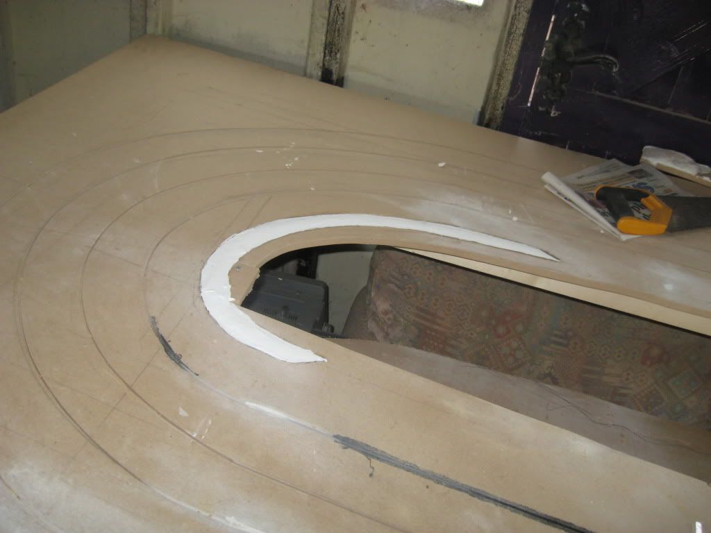

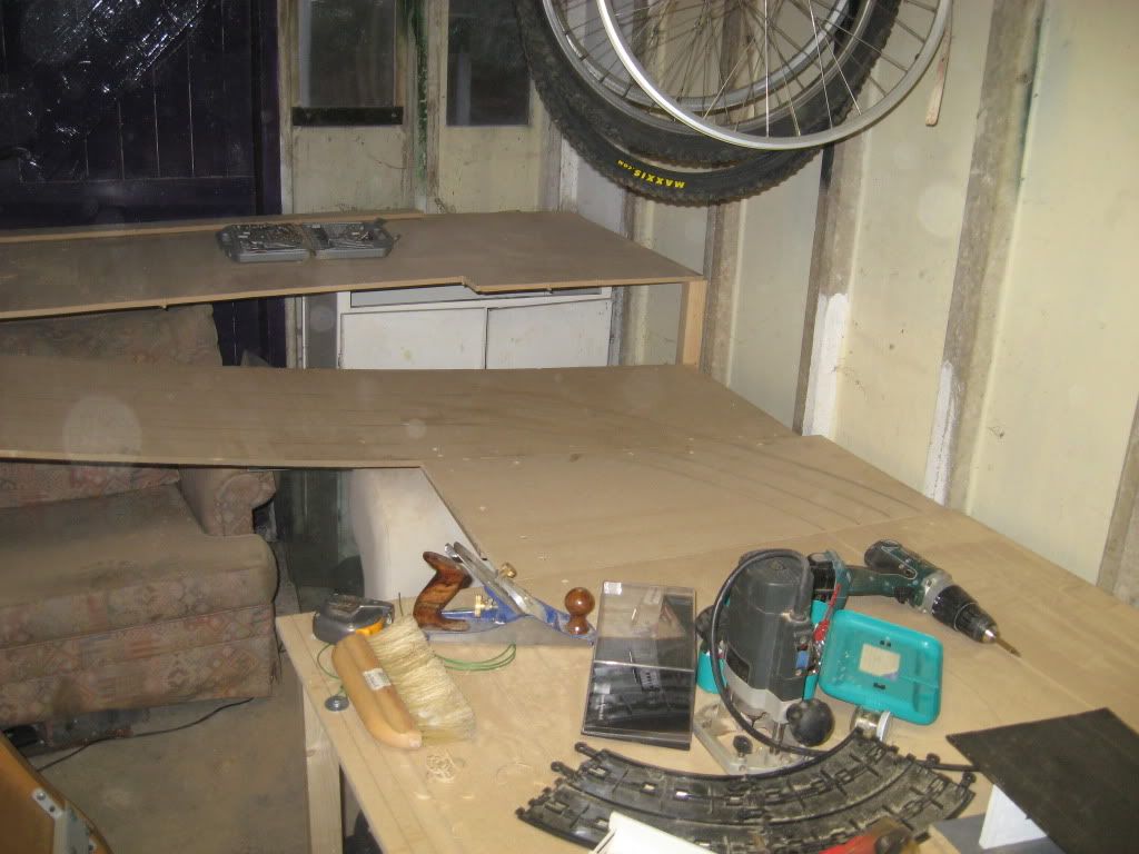

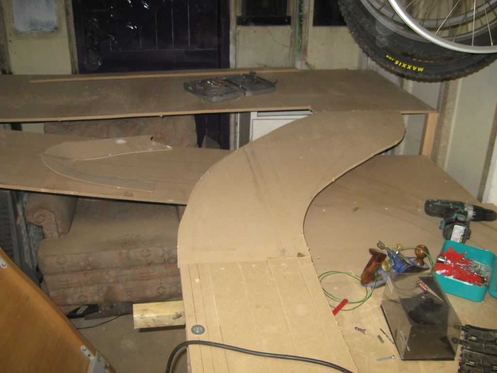

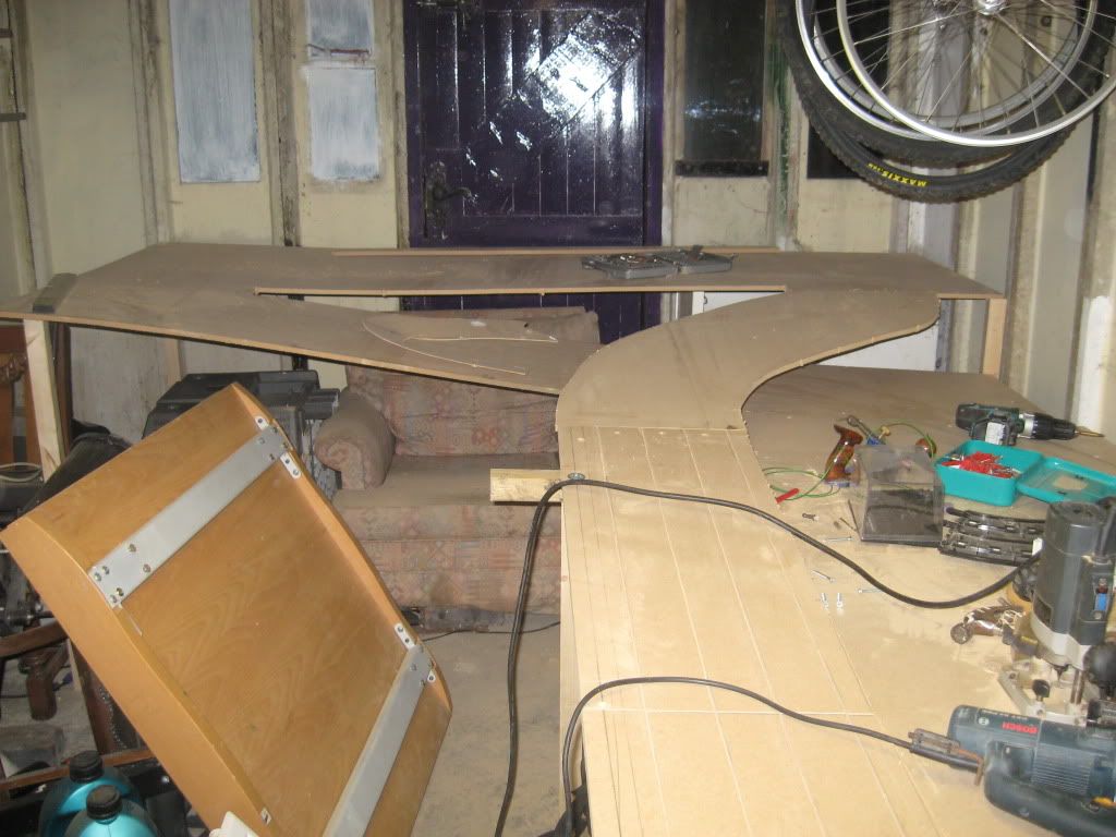

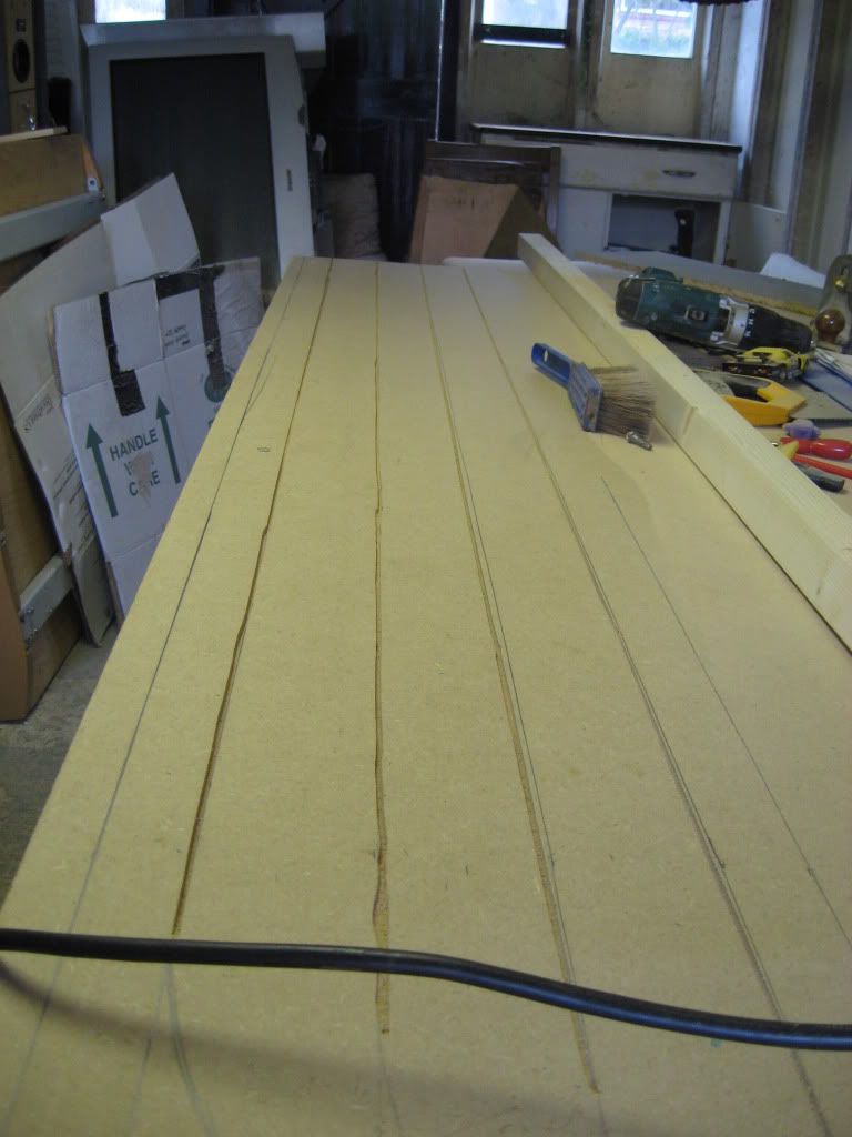

here is a few pictures of my routed track "in the making"
havnt got a name for it yet and the back end isnt yet 100% but im thinking of this as the final design
the red bit will be a bridge to the raised section
the supplies
ready for routing(complete with helper)
penciling in the design
looking towards the soon to be raised section of the track
coming onto the start finnish straight
half way through routing the corner
one lane left to route
comments welcome both good and bad

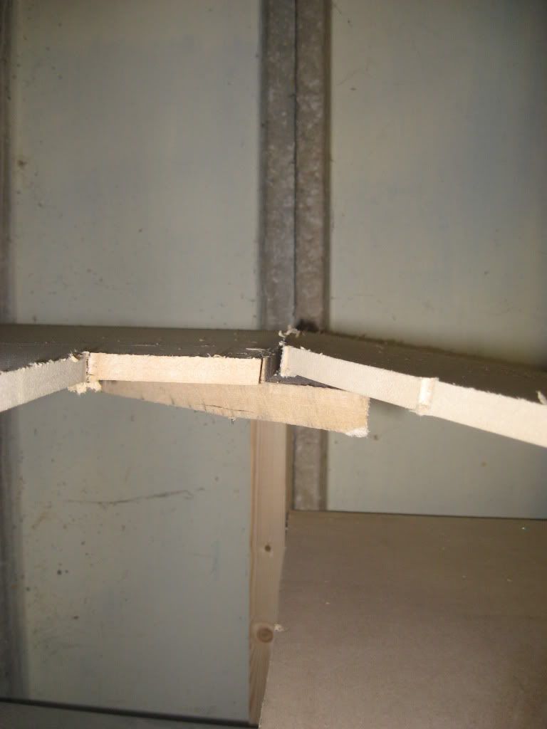

i was wondering whether any one would be able to give me a bit of advice on this next bit at the top of the overpass the angle isnt right

i admire your effort , but i would have used a long staight edge for your straight's , and a tramell for your curves
( sorry i work with routers and MDF and curves for my work , making bespoke kitchens )
fair comment its sort of my first time with a router so there will be some (possibly a lot) of filling
Re- overpass problem
glue a thicker piece underneeth the two top's and usung a sander round over the top to a smooth curve/hump
hth
Also on your up and down boards(MDF planks). Use a circuler saw and make alot of cuts on the underside, 90% to the slots. It will make the boards alot more flexable to shape a smooth incline/decline.
John W.
QUOTE (ju5t1n @ 25 Aug 2009, 19:57) <{POST_SNAPBACK}>i was wondering whether any one would be able to give me a bit of advice on this next bit at the top of the overpass the angle isnt right
Looking at the pic. Can you not just plane/cut the end of the support block @ the same angle as the incline. This will then lower the incline down to marry up to the top. it will also give you a bigger surface area for fixing it in place. you can then use polly filla or similar to fill in any small gaps. Then as Fossil959 says sand the joint to make it smooth.
Hope this helps
Gaz
CB
the fixing block underneath was only there as a temporary measure so i got a better idea of the incline,once ive sorted it out the over pass will be at the same lever but im trying to avoid the cars jumping off at that point.
think ill have a go at what youve recomended cheers guys
got a bit stuck in over tha last couple of days(much to the better halfs dislike) got a lot of the mistacks filled and cheers for the advise on the overpass problem,i screwed the support to the over pass first them when i screwed it to the "moutain section" it pulled the angle right up had a 9v battery hooked up to a car and it went around with no problems

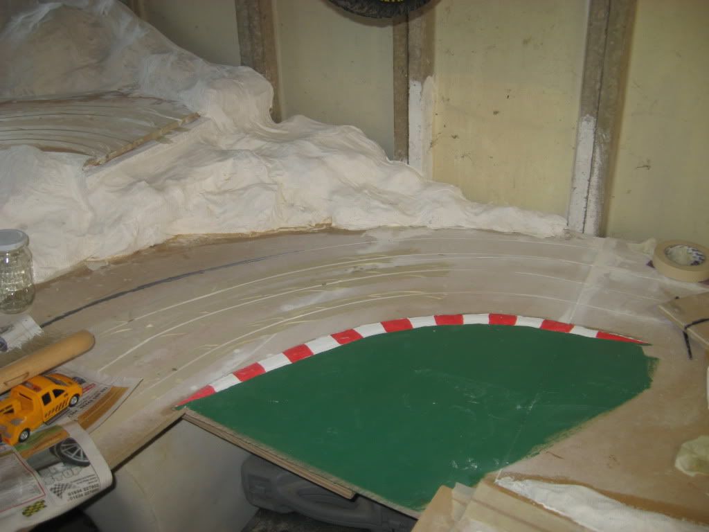

lol i keep looking thinking i could just copper tape it and go,but im biding my time put two of the kurbs in this afternoon and started constructing the mountains
10
been busy yet again put a couple of the kurbs in
getting red for the first lot of mod rock
after the first lot of mod rock
top mountain in construction shame i ran out of mod rock
gave the hairpin kurb a little lick of pain because i had no modrock

i keep doing more and mroe too this track each time i enter my garage and i must admit it is one of the most satisfying things i have ever done looking back over the pictures and how its finally taking shape,from what was a pretty basic drawing on a bit of paper to what it is today,
this corner will shortly b under tha bridge once the lanes and track are painted
the "mountain section" that is really nearing completion and ready to paint on the left side i want to bring the moutains towards the front and slightly round the corner feathering off to under the bridge(which will be on the right)

a question here,havnt been able to work on the track today as i worked late anyway,the mountains are hard if u knock on them as you would a door,but if u press them they seem week,as no one should really be pushing them as such should i not worry or would you recomend giving them another layer
