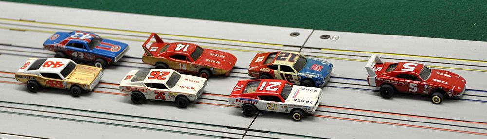

Okay, here's some pics:

Classic AW & JL.
