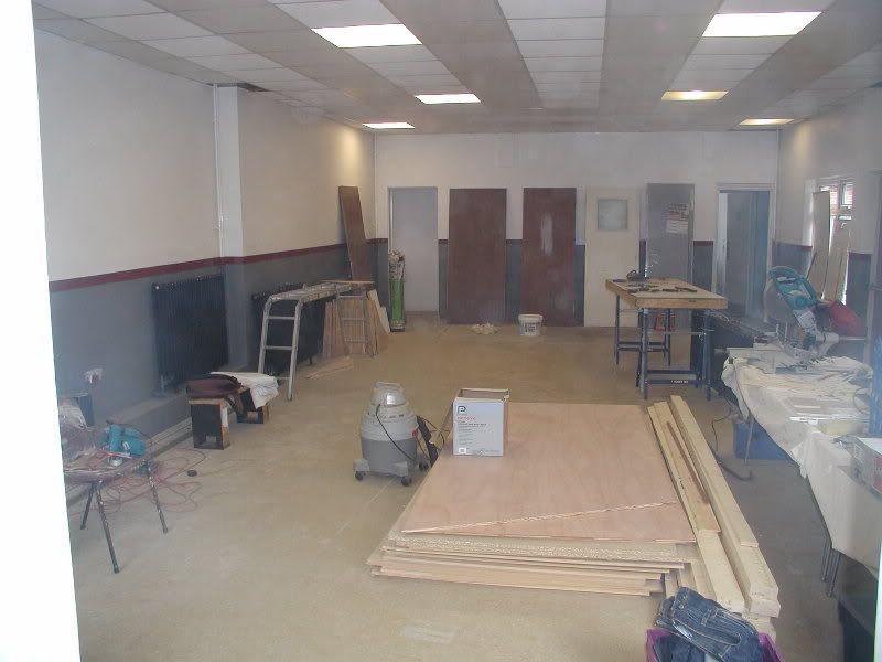

Not so much visible progress over Easter. The main hall painting is complete, and just needs the doors to be re-hung, and the ceiling tiles finished (though these are waiting for the electrics to be done).
We've made a first start on the track supports, and up against the wall on the left (behind tyhe ladder) can be sen the first 70 of the plywood triangles that will go to make the 63 track support legs. We're planning for the track surface to be 750mm above the floor, rising to a max of +250mm. The traingle leg supports are 480mm x 610mm, so 2 of these bolted together will manage all of the different heights.
Other work in the last week has ben concentrating on the other rooms, boxing in pipes and electrics etc.
The lobby has had a large hole in the wall repaired, 2 coats of emulsion, and the doors undercoated.
The main toilet has had the door frames, skirting board, window sill and water pipes undercoated and glossed, and the walls have had 2 coats of emulsion.
The washroom has been treated similarly. The doors themselves still need painting, and the water meter wants to be boxed in.
The kitchen has had broken wall tiles removed, and some of the wall re-plastered
The second washroom is now painted, though there is still the wall in the second toilet to 'make good', wash down and paint.
Hopefully the first 2 track sections will be cut tomorrow, and will have the bracing supports, and joint sections fitted and glued. When this has all dried, we'll be able to join them together, and check that the methods of joining the track sections and fitting the legs is all satisfactory. Watch this space ..... !

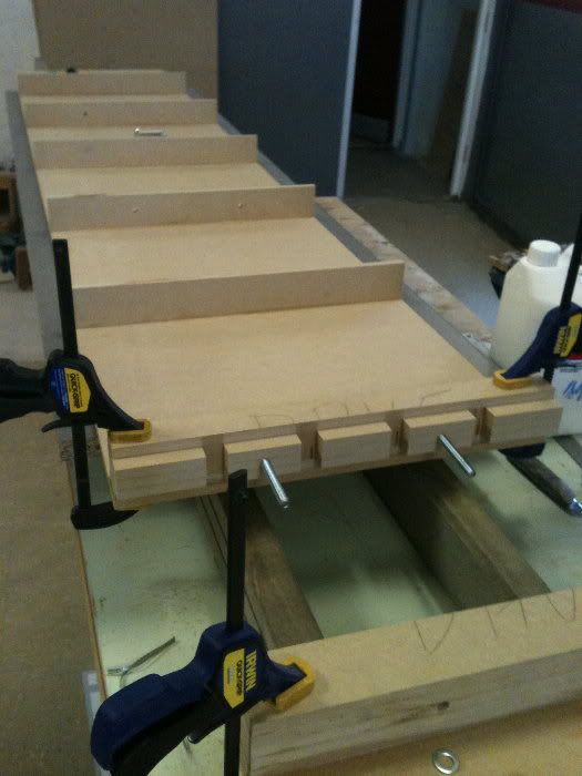

Great stuff, any chance we can have some more detailed photos of how the track joints are made?
Hi Rob,
Below is another picture of our joints. The track is 500mm wide (100mm lane spacing and 100mm run off each side), so we've formed the joints from 500mm long strips of 12mm MDF (an equal number of 40mm wide and 60mm wide). Then we've glued 5 strips on top of one another (a 40mm, then 3 x 60mm and another 40mm) to form a 'tongue' (the one on the right), and another 5 (a 60mm, 3 x 40mm and another 60 mm) to form a 'groove'. These should slide together smoothly. One or two have been a tight fit, and I've 'thinned' the tongue on those by fitting a larger router bit (around 10mm) in my pillar drill and 'milling' a few tenths of a mm of each side. The two halves have then been clamped together and two 10.5mm holes drilled for the M10 connecting coach bolts. Finally, we've made slots down the tongue (approx 20mm wide) for the braid to go through, so that it won't get crimped when the two joint halves are bolted together.
Finally, another picture showing the track partially assembled. We're gluing the joints (bolted together to assure perfect alignment) to the underside of two sections of track which are lined up exactly as we want them. Then the joints are clamped to the track (2 clamps to each half of the joint), and finally the bolts are undone and the track section moved apart and any glue seepage wiped away. We've done it this way, so that there's no risk of accidentally gluing the track sections together. This picture shows at the far end, the start / finish section in front of where the drivers rostrum will be, leading onto the main straight (down the left hand wall in the picture), round the bottom bend and up towards the left hander into the 'finger' (similar in concept to our old track).
Since the picture was taken, we've started getting the main straight barriers fitted. We've clamped a long length of perfectly straight angle iron (borrowed from Ted's workshop) to the top of the track (with as many clamps as we can spare), so that the straight should be completely flat. Then we're gluing and screwing the barrier (12mm MDF) to the sides, which should give the 'I beam' stiffness we want, and prevent any bumps and hollows down the straight. I'll let you know how our skills match the theory !!

Thanks for that Mark, interesting technique for the joints. I presume you have a good way of mass-producing the MDF strips. Track is really coming on and looks like it will be fantastic! Keep it up. Best Rob
Hi Rob,
Yes producing the joints has been a long, hard job - cutting 160 strips accurately, gluing to give a very fine joint tollerancce, drilling for the bolts, cutting out for the braid has all taken a couple of weeks - fortunately we've had a 'Dave' who's fitted this in with a myriad of building repairs as well.
I'd advise anyone building a track to get one !
Mark
