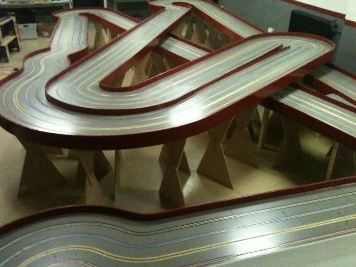

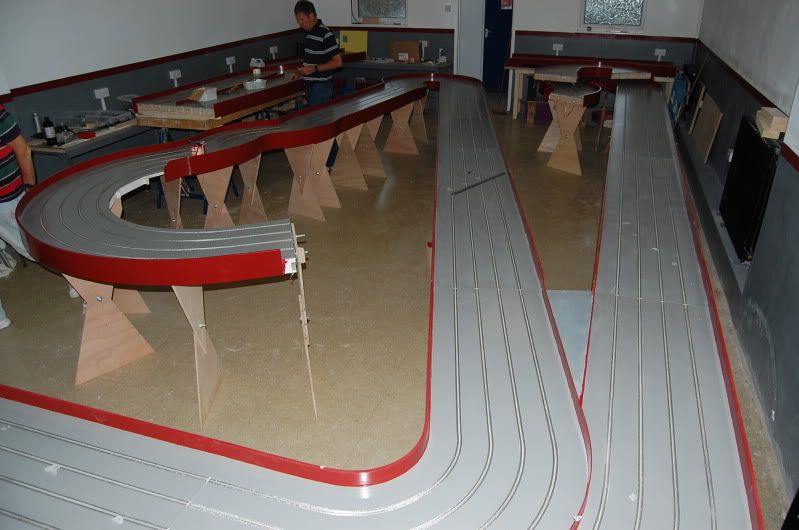

Latest picture of progress as of Friday evening after the first stage of assembly
Hi Dick/Mark
Looking good!
Just a slight concern about the'Jump'!!!
cheers Bill.
Hi Bill,
Yes - thanks for pointing that out - we were sure we'd missed something. However, we knocked up a few more pieces of track yesterday, and finished it off.
Overall, another good day yesterday, with all the club members down at some time or other during the day.
The kitchen is finished, rostrum is fully painted and the controller sockets are being wired up tonight.
Blinds are installed at the two end windows to cut out glare on the track, and tidying up has started, with tools disappearing off home at last.
Just a last bit of fetling to the track joints, and we plan to run tomorrow evening.
