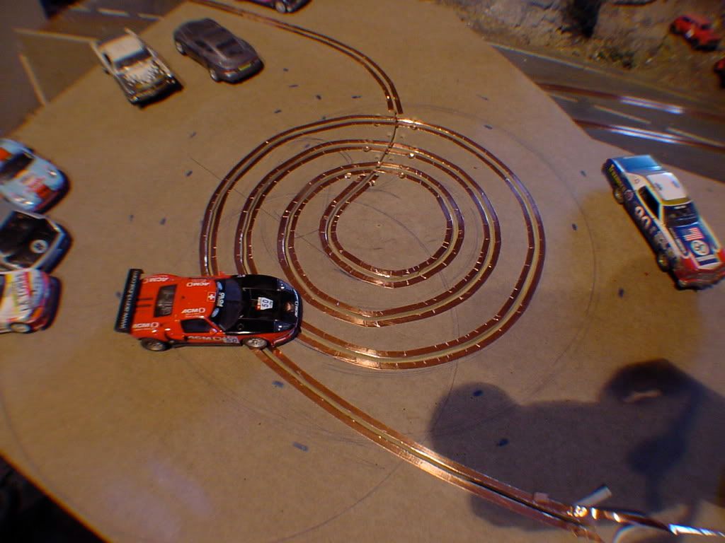

heres the routed bit of the spiral, new and improved...inner radius only 5cm (2 inches ). still need to wire up all the cross overs yet.if you go too slow it sticks, but if the tails out you're ok, then if you go too fast the car tails out at 90 degrees and 'jack knifes' , its dead tricky but great fun, each car needs a different trick it appears....

Oy .. that's almost like my avatar, which [I believe] was drawn up a couple of thousand years ago .. everything is recycled! .. But the cars do cope with that .. not too tight?

Hey! That is the spirit! Advance. The spiral is a great idea I did once something in that spirit, i.e. a track segment that forced sliding. I did not take it to your level because I wanted it to be "realistic" is the rally sense. I really enjoy your go beyond the beaten track slot approach.
On the apprehensive side I think that you might have gone too far, or shall I say too in, in your spiral. Can you put a video with a car going through it? It might motivate me to extend my forced sliding element in the track I am building.
That looks so cool! Reminds me of a rally car ripping up the handbrake and doing a full on smokey doughnut then driving off
just been trying it...done the lead in now and the electrical connections, works fine, after learning the ropes a bit, the inner diameter pretty much stops the car dead but if the throttle is up the back wheels skid round, slide the tail out and off you go, runs smooth and then ease off as you go out other wise the drift goes too extreme, the ideal angle is 45 degrees to the slot, if it swings too hard it goes off to 90 degrees and either stops the car (looses contact with guide) or jumps back on the guide spring. to be honest i don't see what all the fuss is about, you could easy do a hairpin at this radius. just need to learn the road! i'll be putting a post or telegraph pole in the middle, it somehow helps visualise the drift with the centre marked

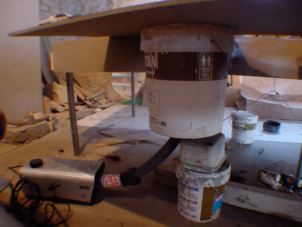

now heres the thing.......
as luck would have it last week i got a smoke machine for the halloween night.....so add 2+2 and get an effect for burning rubber on a slot track,!!! if i drill a hole in the centre of the spiral connected to a length of flexible tube going to the nozzle of the machine then as soon as the car passes a sensor going into the burnout the machine fires and as if by magic smoke from the tyres! which the car as it spins then dissipates around
just had a little try and it looks remarkably realistic
oh dont i just need to get that vid editing program sorted out, cant show you anything!!!

ok so it works, but not with a hole in the middle, yoou have to drill little holes in the slot so the smoke comes up from the slot on the inner most curves of the spiral, then i rigged up an old paint bucket as the smoke store so that it comes out of the holes slower, the effect is ok, but needs to be done propwerly and with an electronic sensor otherwise you can't concfentrate on actually doing the donut!

Brilliant!!! Even the still photos look oh-so-good.
WoW!! You now introduced special effects into the slot world. Are going to set up a trigger so that when the car enters the inner circles the smoke starts coming out? You are raising the bar too high for us to follow. Please keep going at it.
QUOTE (rallyP @ 6 Nov 2009, 06:20) <{POST_SNAPBACK}>You now introduced special effects into the slot world.
Yup...pretty amazing. Just imagine the possibilities!!!
Cool as hell
I have always wanted to do that to my industial are smoke coming out pipe etc. etc.
