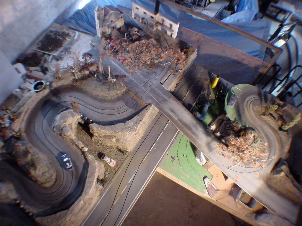

some softer fotos, i need to sort out the treatment where it joins the green area and the bridge but hey....!
That feature tree was a great find. It's brilliant. Love it even in its dead/autumnal tones. BTW: do you know what species it is?
Embs

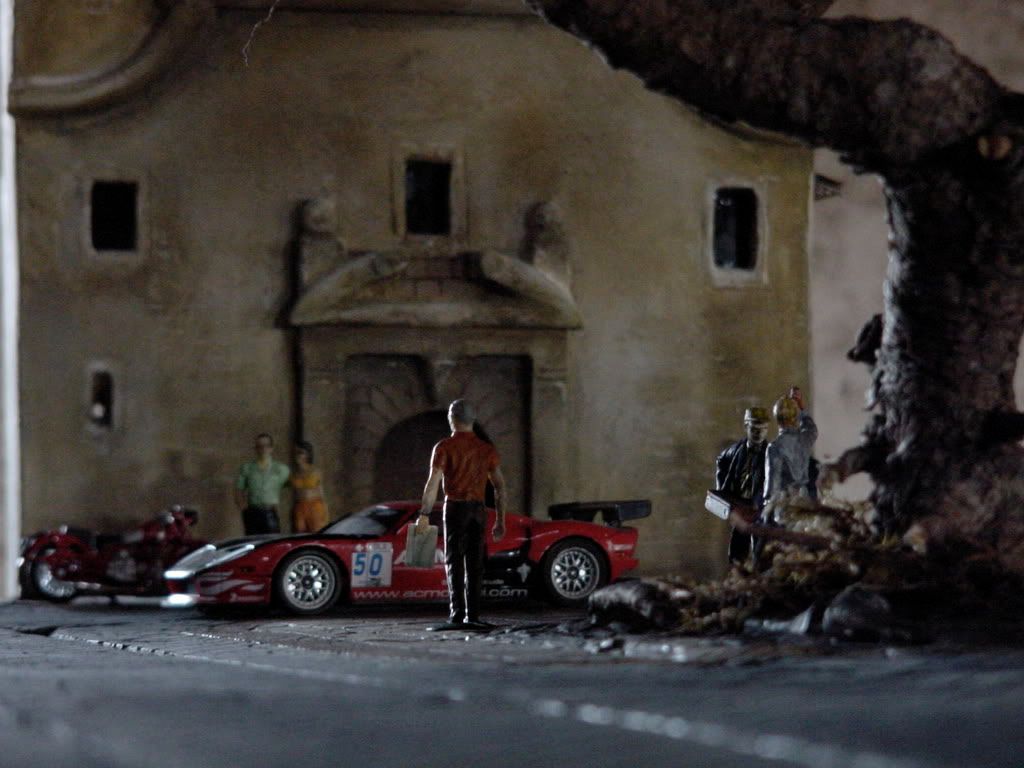

Picture #3 in post #60, the low angle overview looks just fantastic! I especially like that the roots of the tree has cracked the pavement. Very neat detail, that!
But I wonder, how will plaster stand for wear & tear .. Do you just *seal* it with a coat of paint?

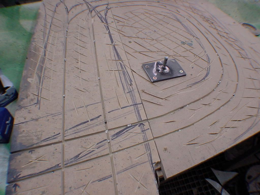

My worries with the plaster were about the slot part and not about the track surface. But of course there is the slot in the MDF below it, so not trouble will occur (I had not noticed the picture with the slot on the MDF).
Probably no real trouble, but will want to vacuum/hoover out the slots every so often to get out any plaster dust or rubble that comes off into the slot.

OK at last i managed to download the precursor to the laying of the plaster in the plaza to make everything clear, showing the carved up mdf and the pole for the tree to rest on

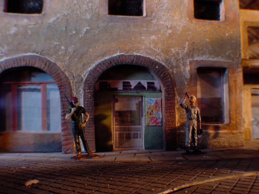

been out with the camera, tking fotos of the bar windows, and doors, and accesories (ice cream, black board etc), then resize with a bit of photoshop jiggery pockery and bob's your uncle, instant bar!!, just need the sun shade and aluminium chairs!!??

The bar is looking great. Love the fellow with the early ' brick' mobile phone (or is it a walkie talkie).
Would love to see the real building, inside and out!
