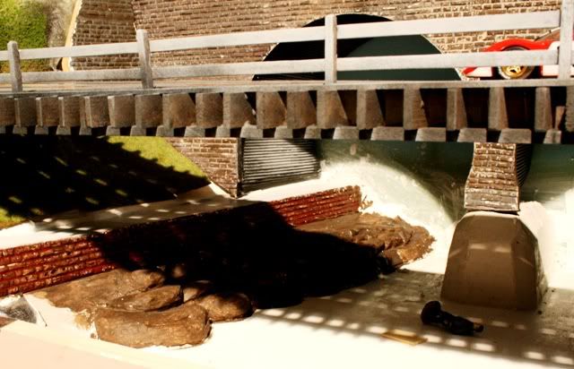

Splashed around a few colours on the scenery and the bridge today just to get some sealer coats on it and try some colours. I'll have to wait for the plaster to dry before I can go any to much further with it. The bridge has been sprayed. Also attaching some photos of some ideas I've yet to put into the track.

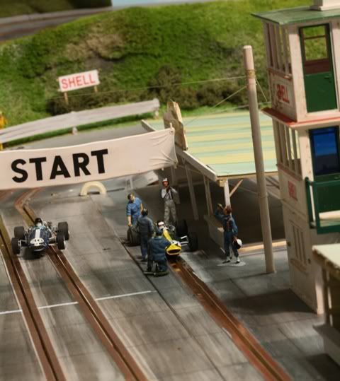

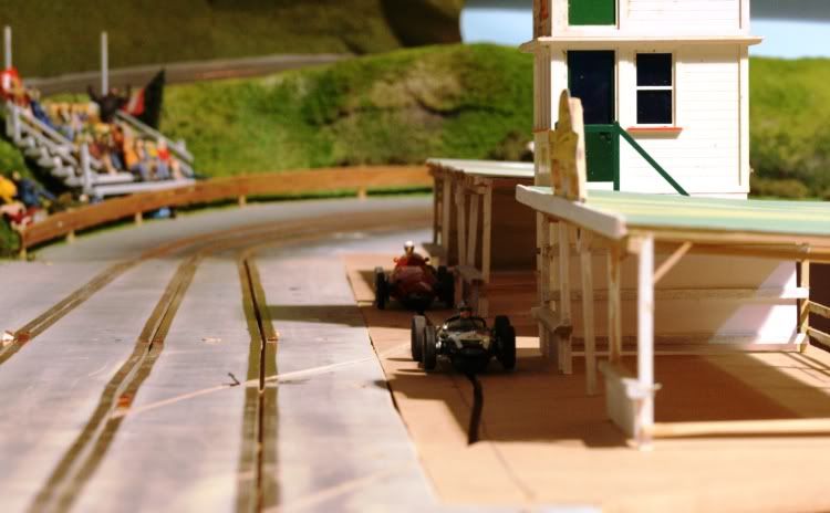

Started work on the roadway for the pits and routed out the exit grooves. I'm not looking for too much in the way of a realistic in-out type pit situation as this track will be used mostly by novices. It should make for a nice exit from a pit box.

Still work to go. Plaster drying on the banks of the river. Trialing some floor polish for water at the moment. Time will tell....

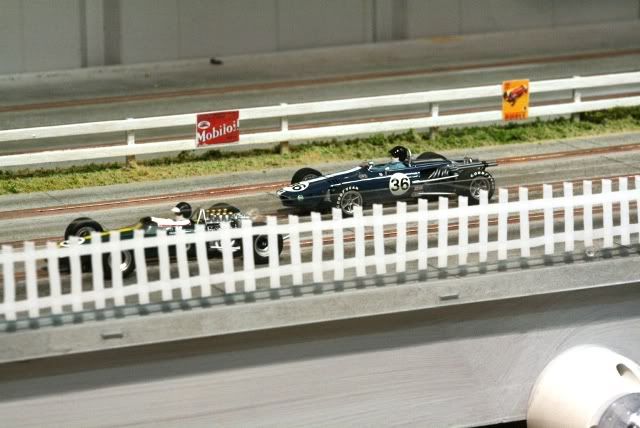

Painted some stripes on the perspex sheets fitted to the side of the track hoping they would look like fence palings. It wipes off easy enough so I think they work well enough to paint them in a bit more realistically. But not today.
Pits and buildings in place. Pits got clobbered the other day when the dog came running into the shed with a possum about half an inch in front of her nose. The possum ran up a piece of timber and kicked it over subsequently falling straight onto the pits. ( .gotta be happy with that. )

Very nice. I like the racing line, is that done with dry brush? Also is that a mercedes w154 in the corner?

AlexB, the track is painted grey then I get some black spray an just standback and try and get the lines right. Nothing too elaborate.

Jmswms, don't go too far away. I'm about to get into my water at the bottom of the bridges. If you know where a link is to how you did yours is that would be great.

But..... there's always a but...... the START/FINISH banner!
You should make a new one printed on silk paper!!!
The plastic is too heavy!!!!
I think you have to search the forum for another topic.
Someone did some banners or his track and they came out very well.
But the local bookshop should have such a paper, I think.
UK:
Look at post #40 in the thread covering LMP's routed track Silk Banner. Another appraoch to take with the banners is to use very thin sheet styrene. This is the approach that I intend to take because it will allow the use of decals. My thinking is that the decals will print out with better precision/clarity. Styrene may also make for a better material to weather. A billowing or wind blown effect can be achieved by heating the styrene. The wrinkles at the cable grommets can be created by using putty. Here is a picture of some flags I made using styrene.
The flags are quite different from a banner so I may be off target on my expectations for how well suited the material will be in creating a banner.
Brad
