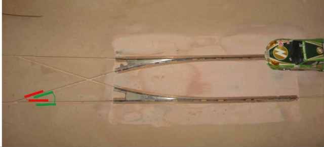

Great track. You inspired me to make some new wood extended XlC's to add to my plastic track. I have a question about how you hooked up the cross over section. The Scalextric plastic track has the 2 left and 2 right tracks connected with wires under the track. The red and green sections I added to your photo. How did you make this connection on the new wood section of your XLC. Or is there another way to power those "inner lanes" ?
thanks,
Steve

Thanks Steve, i just basically countersunk 8 fine Brass countersunk screws flush with the surface before taping, then put a hole through the tape where the screw is once the copper tape is laid then fill the hole with solder and i used a solder sucker if i got any excess which would then make the solder flush with the surface and where the screws protrude underneath the table i soldered wires joining the screws together here is a couple of pics
i hope the pics help
Cheers John
