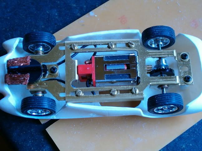

Just for a change I thought I would show you a "work in progress".
I like several others on this Forum bought some resin bodies of 50's Classic Sports Racers from American Company Resilient Resins. I also wanted to try one of EJ Hobby's Retro Brass Chassis, so this seemed a good idea to combine the two items together.
Work on this Ferrari 250 so far involves building the chassis, (real nut & bolt job), making some body mounting posts and roughly preparing the body.
The results to date are shown below :-
The body is supplied with a lexan windscheield, but there are no dashboard details, steering wheel, driver figure or the all important (for this particular car) exhaust system. I do think Resilient need to include these items on future releases.
The resin is fairly thin in places and the body needs a fair degree of finishing to get a decent shape. It does however, appear to be fairly accurate, much better for instance than the same car offered by Ninco.
The wheels and tyres used are Pink Kar Ferrari GTO ones, and I must admit my first impressions of the tyres were , what rubbish, throw them away!, but I then tried the rolling chassis on my test track, (slippy ole' Scalex Sport), and the grip levels were very good, better than Ninco Classics !, remember we are talking non-mag here, so I may well keep them. I just wonder if the extra grip on Sport Track is generated from the heavy ribbed pattern on the Pink Kar tyres....Interesting.
The chassis is a work of art, (if you love retro chassis), and is really a copy of the original Strombecker one. The chassis is supplied with a couple of alternate motor mounts and 1/8th oilites. Keeping the American theme, I fitted some 3/32nd oiites from Professor Motor and a TSRF Guide system. The chassis was given to me by Paul (Revvvs) Reveley,after I expressed an interest in these chassis in an earlier post, thanks Paul I owe you one.
As for the motor......The Dark Prince of the Desert, Mr. R. Sheldon sent me no less than 4 Team Slot motors to try out. If you have not seen these before, they are great brutes of motors, the can being finished in chrome with red Endbell sections, just right for the 50's/60's feel of the car. Axles, Crown wheel and pinion are Slot.it

Alan,
Saw a dark red Ferrari Testa Rossa at Lime Rock last Monday; it was not the fastest car, but it was a beauty.
Motor you selected is looking healthy. The pedigree is good! The Vintage setup would be axle spacers between hub and bearing on each side, with crown gear having no groove for the motor shaft (it's the only system I know!).
You may find that you get better grip if you stiffen the rear axle carrier so it cannot vibrate relative to the rest of the frame. I fixed a Monogram frame this way, with HO rails running beside the motor all the way to the rear motor mounts, soldered the whole length. Other guys stiffen the frame with tubes from the top of the bearing carriers to the motor mount bracket, making it a space frame at the rear. But I prefer rails soldered to the underside, where the weight is needed. The EJ's chassis is a repro of the Strombecker frame, which was copied from the Monogram frame of 1964, which was inspired by chassis scratch built by the midwestern US club racers of that era, who used heavy brass, not that thin-gauge stuff.
Also, you might want to experiment with a loose body mount. Put a blob of some rubbery glue in each of the screw holes, to damp the vibration of the body on the chassis.
The car is looking good!

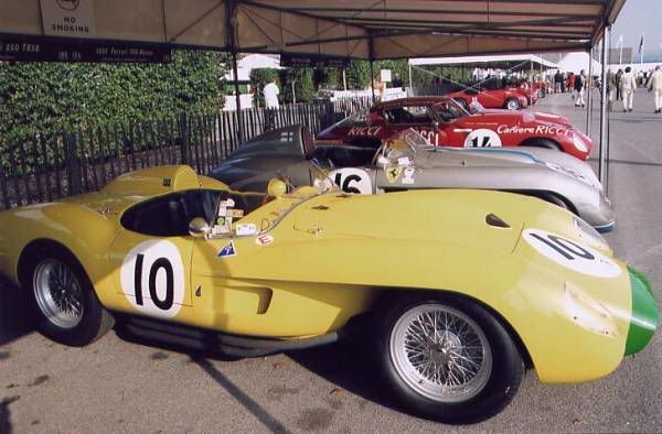

Thanks for posting Alan. I was thinking of getting a couple of these bodies but some of the cars looked a little "slab sided" to my eye: the Scarab for instance, although Iceman's examples have turned out very nicely. And, your Ferrari is looking great too

Thanks for your comments and ideas Chaps.....I think I am more confused now than when I started.
I've got to admit I was very tempted to go with the old bevel gears, Patto's does some lovely stuff, but in the end Slot.it won out, at least I have plenty of spare crowns and pinions. My chassis has rear mounting pegs which hold the chassis fairly rigidly so I'm going to hold off any additional bracing sections until I've run the car a little more. I do see what you mean about the thin metal at the rear of the chassis and "beefing" up this area would work.

David...Great photography as usual, I do like the yellow car, not sure about the green nose band ...reminds me of Norwich City's football strip!. I love the Sebring car but it does seem to have a strange exhaust system, doesn't seem macho enough for the car with that tiny rear exit pipe!. I might have a go making some decals for this one.

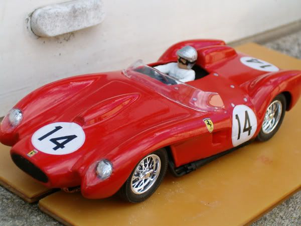

Thanks for all your suggestions as to which, (of the many), 250's to build.
After some further research I thought I had better finish the car as the 1958 Le Mans winning car of Olivier Gendebien and Phil Hill. Especially after reading Phil's comments on a very wet race :-
"It was impossible to see the smaller and slower cars in the rain and darkness. I drove down the Mulsanne straight at top speed and waited to hear the resonance of exhaust in front of me. As soon as I could sense the location of a car in the blackness, it was a flash of light, the bare outline of car and driver and then back into the darkness, peering ahead for the next one." Hill sat on a tool bag to see over the windscreen. "I picked up a full lap that night mainly because I could see and the others couldn't."
I did manage to make some headlight openings for the car using my trusty old Dremmel and a cone shaped stone tool, fairly straightforward really, a set of Mini-Cooper headlights and then some I shaped some headlight covers, (after about 6 attempts!), using Howmet's hole in a slab of wood method., (I also burnt my finger!).
Grille is small mesh from 4D Models, Driver Torso from Fly, Head from Maxi-Models and exhaust from my spares box, made up from many different parts. I made a "ledge" to cover the motor and to provide a base for the driver figure. Part of an Airfix MGB dasboard was used together with a steering wheel I had in the spares box.
Look forward to building many more models from this manufacturer.

Thanks Paul......The chassis runs very well, they really are superb. Although it has fairly high ground clearance it does hold the corners very well, I think the TSRF Guide helps a lot with it's deeper profile and the Pink Kar tyres are excellent.
Once again thanks very much for letting me have it.
As for the Cunningham.....I'm afraid the EJ Chassis is just too long, even when a trailing guide is fitted. I could have made it fit but it would have required either cutting the chassis or the superb bodywork on the Cunningham, neither of which I wanted to do. So it looks like a scratchbuild, but it won't be anything like Howmet's masterpeice.

Thanks for the comments Chaps.
Really impressed with these shells and I hope to build more of them, (now I seem to have cracked the headlight problem!).
JP.....Do you have any influence with Mrs.H, as I need a hand knitted finger cover and I thought you might be able to help, I know she admires your ability to manipulate brass.

Great work Alan! I'll echo David's comments, "it looks right".
David, I recently received one of the Lotus 25 shells. While it's not as finished as say a Beardog resin, it's not too bad. It looks true to scale. Very small. Smaller that my Super Shells Lotus 25.
