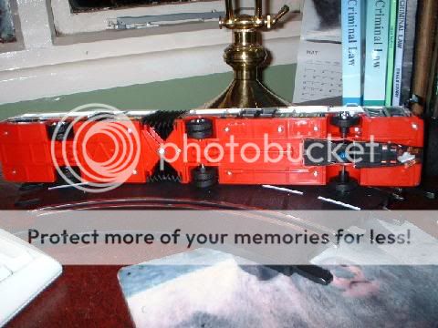

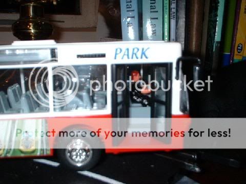

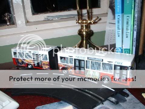

While I wait patiently for the competition window winders for my Imp to arrive I thougt I'd build something to rival Difflocks Party wagon , I found this little beast on the shelf at my local branch of Wilkinsons ,might have some appeal to our Swiss and German friends as it apears to hail from that part of the world
Motive power comes from a Polistil F1 chassis suitably chopped
I will probably have to add a magnet and make some silicon tyres to get enough traction as the original tyres are very plastic

It hasnt run on the track yet I may have to put a second guide on to make sure it turns , I will be testing it on my track today but I wont get to try it at the club till thursday , I found the plastic convolutions a little stiff so I sliced part through alturnate segments to loosen it up a bit .
Will keep you all informed of the progress

test 1 results rubbish back to the drawing board , the polistil motor just isnt man enough for the job and the bendy section proved to be not flexible enough so i think I may get a better result if I power both sections seperatly
more later:-

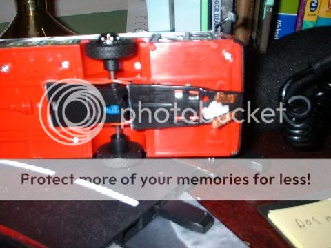

After the some what disasterous debut of Bendy Bus,I took it back to the depot and loked at where the original went wrong .Two problems imediatly showed up .One it weighed 350 grams ,twice the weight of a Chris Briggs proxy car and Two the flexy bit in the middle wasnt flexy enough .
Cure :- get rid of the polistil motor and make the centre more flexy.
I cut the rear axle out of the front coach and fitted a scalex one I then cut enough of the floor out to fit a scalex motor ,the motor was glued directly into the chassis taking care to make sure the gear mesh was good I glued 2 bearing into hold the front axle and then screwed the front 1/2 of an old scalex chassis in place to act as a guide holder.
The rear wheels were bushe with 3/32" brass tube and glued on .Rather than making some silicon tyres as time was now short I added a small traction magnet to the underside of the motor , sticking it to a piece of shim steel so I could bend it closer to the track if needed.
The flexible centre wa replaced with a bit of black polythene cut from a bag to make sure it would bend when it cornered .
I dont know how it will go against party waggon but it corners and stops wether that will be enough we will see on thursday .
