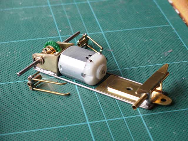

I then dozed through the F1 qualifying session on TV and woke refreshed for an hour or so in the model room soldering up an F1 chassis.
I put together the chassis while listening to my choice of music as well as browsing through magazines and books for other ideas for future slot cars.

Here's the chassis.

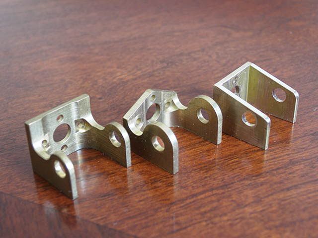

Steve and John - Yes it is a bracket by Chas Keeling available from http://www.scdparma.fsnet.co.uk/

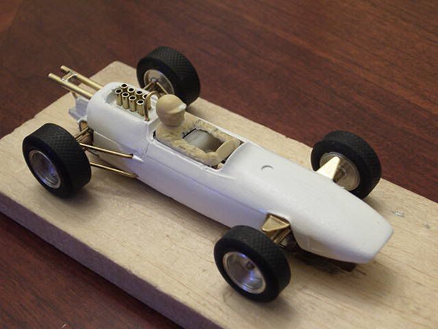

I thought I would try some suspension detail and came up with this, because of the radius rods I couldn't build it in place so I arranged the parts around a brass tube spacer that can be put on and removed when maintaining the car.
Once the bodyshell is on I can slip the suspension detail on and they will be retained by the wheels and the radius rod location holes in the shell.
That gentle humming sound you can hear is Colin Chapman spinning in his grave, I know it's not that pretty or accurate but it's my first try and I've learnt some useful ideas for the next one I build. I know it hasn't got springs and anti roll bars but it achieves the impression I wanted for this car.
All I've got to do now is work out how much of Jim Clark will fit into the very little space available.

Here's the SCD bracket on the right of the picture with two BWA brackets. The main difference is that the SCD is narrower and measures at 19mm or .75"
QUOTE (JohnP @ 27 Jul 2004, 19:11)Goodness! Impressive keeping that little lot all in the right place while you soldered it up. Any tips gratefully received David
I work in a fabricator's style rather than the pure engineering approach of someone like EM and I start with half an idea and problem solve along the way discarding pieces and re-doing it if necessary. With the suspension it went smoothly in one go although I part built a practice piece one first to check the design.
To hold the bits in place;
I started with the axle tube/spacer which I cut to size.
Then using square section tube for the uprights I drilled the holes for the radius rods at right angles then cut to length.
I ran a round needle file over a bit of wood to leave a shallow channel that the axle tube would sit in while I soldered the two square section upright pieces in place - the channel allowed the uprights to be on the centre line of the tube.
I drilled the holes in the body for the radius rods.
I put the body on the chassis and taped it in place, slipped the two axle tubes/uprights onto the axle then bent and cut brass rod to fit between the axle and the body.
Once I was happy with the fit of all the pieces I put the car on the workmate, and used the nose of pliers to act as heatsinks and the weight of the pliers braced the assembly while I soldered them in situ.
I soldered the bottom links with the car upside down for obvious resaons
Hope this makes sense!?

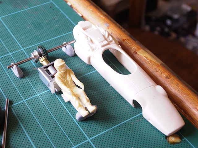

I managed to get Jim Clark to fit by recasting the driver figure with a bit more depth of resin than the original which gave me more to work with, channeling out a recess for the top of the motor so Jim can sit over and around the Mabuchi. Space was so tight I had to snip half the motor lead/brush tabs off. It's not perfect painting it will hide a mulitude of sins.

Steve - If you use an SCD bracket remember it's 19mm wide so check it fits the bodyshell you're using.

After a bit of back surgery on poor old Jim Clark I could get the gear/motor/driver all into the available space in the 43 shell, the close up cockpit shot proves it's all in there as you can just see the armature windings behind the driver.
