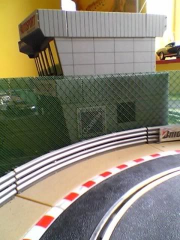

I used 'Greenhouse Shade' which I stumbled across in my local diy store about 6 months ago. It is fixed in 2 ways, round the track edges it is tied to the vertial posts of the armco with a little bit of wire every 6 inches or so...(or 10 if you ask the missus...ahem!) Around the paddock I have used some wooden dowels, again from the diy store and tied the fence onto the dowels with wire again.
(Sorry about the image quality, quickly taken on a camera phone.)
I was going to spray the posts and fence silver but when I put it up I actually quite liked the colours
If you are looking to build fences - gutter guard is great stuff and fuse wire make great ties and are easy to use.
