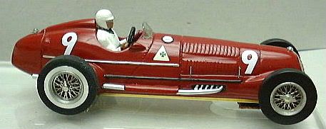

Wonderful Alfa Russell.
What motor is in it?........Looks like something Fergy would fit to one of his cars.
Alan
PS The colour looks superb, what paint did you use?
Hi Alan,
The motor is a shortened Mabuchi 'S' can with a turned-down Mura 'C' endbell. The armature is a Slot.it 26K, balanced by Best of the West.
Here's a picture of the chassis alongside EM's similar Plafit-powered car, to give you an idea of the size of the motor. Apologies for the poor quality of the picture.
I seem to recall that I used a tin of Humbrol maroon paint for the body. Having won two Marconi Foundation Charity proxy races, the car now proudly resides in the Marconi Automotive museum in Tustin, CA.
