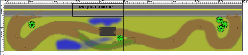

The other element to my plan has to be carving out a place for my SCX Rally Box, which I bought cheap at a LHS closeout a while back. So, I redesigned (again) to find a place for it. I also want to test the design of the swapout section. I'll build this with elevations of 5", essentially the long straight will be elevated. I'm trying to figure out much length I might "squeeze" in if I used squeeze sections for the right side of the rally section. Is this too tight? I estimated the sections using the width of R1s on my Scalextric track.

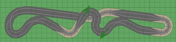

I decided to play about with a bit of elevated track design and using a few r2 lane changers too get some nicer radius bits going on. Here is where I am so far but it's a little over length so I need to lose a bit somewhere ...
what do we think ?
QUOTE (RobBG @ 10 Mar 2008, 00:14) <{POST_SNAPBACK}>I decided to play about with a bit of elevated track design and using a few r2 lane changers too get some nicer radius bits going on. Here is where I am so far but it's a little over length so I need to lose a bit somewhere ...You lost your rally start, which I liked. It's better to have straights through tunnels (under elevated track) so that you're not deslotting in the tunnel. Looks fun to drive though.
Depending on the direction of travel I don't think the elevated section will prove a problem. Left to right especially, as the track is only two feet deep. I guess it's only one car at a time so crashes aren't going to be damaging, unless you fall on the floor.
In fact if the two R1s are replaced with hairpins and a couple of half straights there would be room for the, now famous, Lane Swerve Chicane!
I dont think they will fit will they Graham ? - it's all got to stay in 2 feet wide !
QUOTE (RobBG @ 10 Mar 2008, 16:58) <{POST_SNAPBACK}>I dont think they will fit will they Graham ? - it's all got to stay in 2 feet wide !
If you can move the two R1s in the direction of the arrows by half a straight each there is room for a, (dare I say it?) now famous, Lane Swerve Chicane in the middle. You need to buy two hairpin sets and cut the overlapping pair.
Sorry I don't have a track planner or I could provide a pitcure. Scaley don't do a, now famous.....etc. yet.

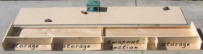

Well, I got started. Went to Home Depot and got the MDF and the wood for the frame. Unfortunately, Home Depot didn't have the proper router bit, but we can get started without the router bit.
Here's the frame, and the outline of the track on the MDF. The main straight is raised about 5 inches and I'll put storage under it.
And, here's the general outline--as it currently stands-- of the layout. STill thinking about the details and suggestions still welcome. The main straight will be about 10' and elevated about 5". The road will go offroad and dip down...

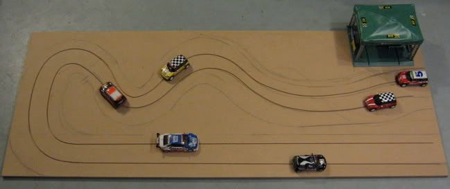

I got started on the routing today with the help of a friend from our club. (Actually, he routed his own track-- a very cool 4-laner you can see on YouTube). Basically, we got the left side routed in about two hours work. Now that I've got the hang of it, it should go even faster. We used Luf's flex strip for the routing. I didn't get the turns quite as tight as the plan (because we thought the strip might break), but I'm pretty pleased nevertheless on how smooth these turns are. Obviously, it's a sqeeze section here before the straight so you'll have to make your pass before the switchbacks!
