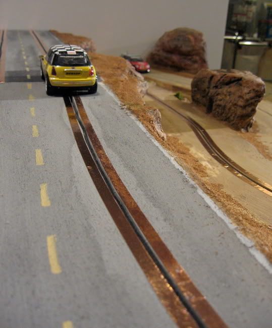

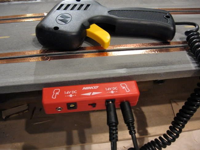

For the electrical, I'm trying to KISS ("keep it simple"). I bought a Ninco terminal track, removed it from the plastic, and wired it up. Now some copper tape, and it works. Here's what it looks like.
So excited, I had to tape one lane just to see if it all worked. I'm using simple pressure contact points for the joins between the tables and the swapout section. Seems to work okay. Will try to finish the taping in the next couple of days.

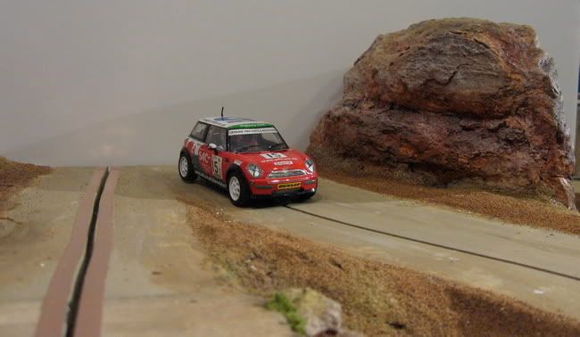

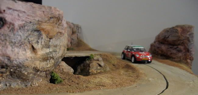

Also, I had one last rock formation to finish off and paint. A few photos... the new formation is in the top right

This is really looking good now Bill! Some of the best modelling I have seen since your previous Targa track!

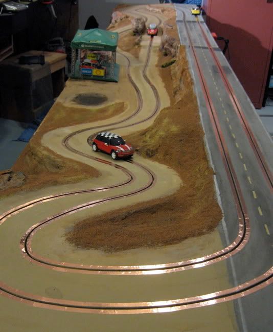

Well, it's all together and taped now. But I've got to figure out a simple way to create more reliable power joins between the two tables--right now I'm just using contact points, but there's not enough reliable contact. And, I've got to get a simple catchment system in place for cars that go off the table. But the cars run pretty nicely on it.

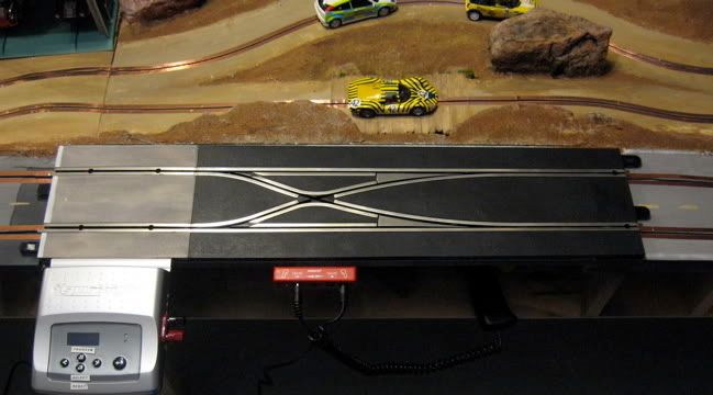

QUOTE (col_de_turini @ 26 Apr 2008, 12:01) <{POST_SNAPBACK}>Why not just use a digital powerbase? No lane-changing involved on this layout but you would have brakes and other stuff.Actually, as the title suggests, I did plan to have a digital section, which is why I put in the "swapout section." And, I bought the digital components to just drop into this section, as you can see in this photo. So, I could easily make it digital with lane changing, but as I don't plan to keep this track, I've decided not to actually put in the digital. So, for now, I'll just drive my limited selection of non-digital cars on the track (and also look forward to more SSD DPR cars).

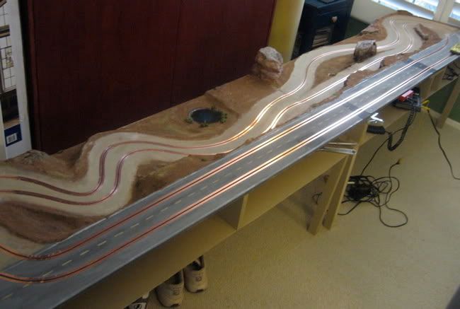

I've relocated the portable track in my office at home so I can just wheel around and take a few laps. I also hooked up a small Model Power train transformer for power, which lets me dial down the power so the cars can run around at more reasonable speeds. I'm starting to put in the oasis, but still waiting for the palm trees that I got on Ebay. I used Envirotex for the water, which exhibits its usual "creep" so I'll have to correct that--perhaps with more "water" and some touch up around the edges.
Looking great Bill, I really like the simplicity of the whole project and the colouring of the road is fantastic, the creep looks as though the water is evaporating from the sun! Is the long grass home made or modeling product?
