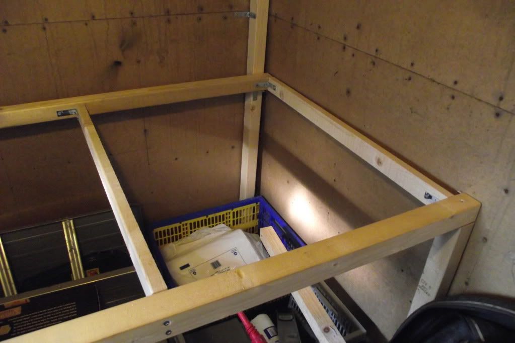

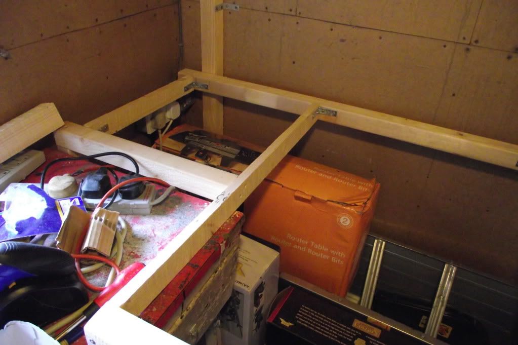

Anyway this is the framework for the main baseboard.
made using 2"x2" and 2"x1"
The legs and front and back rail are 2"x2"
the cross members are 2"x1"
The base board was the covered with some old MDF shelving I had the idea being to cover it with some 1/2" thick sundelar board (pinboard). The thought being that I can fix scenery items with short pins pressed into the board with no drilling needed. If I need to move something I just pull it up and reposition it. The resulting pin hole can be covered with a dab of paint etc.

This is how I am supporting the raised levels.
Using shelf brackets nothing need to come up from the baseboard.
The level 2 boards will need a small frame made from 1"x1" and I have the option of placing cross peices above the shelf brackets or clamping the shelf brackets between the MDF and frame, this method will I think let me be more flexable the the MDF for sloops between levels.

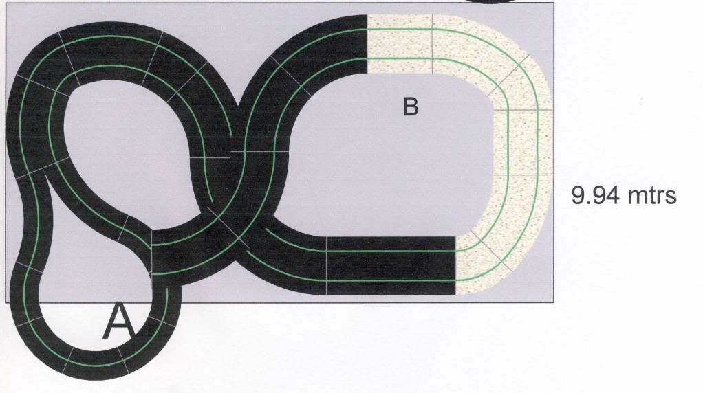

Ok I've tried out a possible layout for the baseboard the problem is to fit a reasonable amount of track and loop on the board
This is an idea
The righthand half
and the left half
If I went with this the front left would probably be done as a tunnel and the drop over the loop as a bridge.

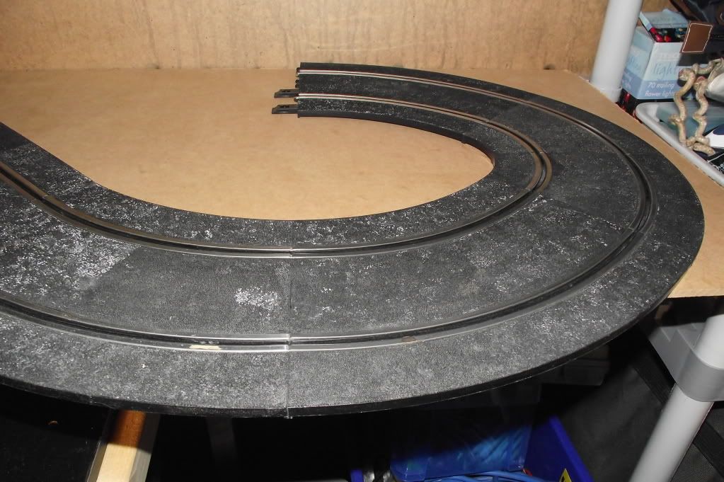

This is were I could do with some help and advise with painting the track. I think I will try Plasticote Stone finish paint for the raised section of the track as this will be tarmac road and also for the normal track on the baseboard but in the light grey colour or even the pinkish one as this will be gavel road surface. But I need to paint the snow track I still want to keep it slippery as I intend to paint it brown / sand to represent mud/dirt track. As can be seen in the video at the moment it is way to slippery (I run most of my cars without magnets). As ideas on a paint type available in the UK that will give the snow track some slip but will not have a glossy finish and will stick to the very smooth shiney plastic. I Think I may have to try some of the paint designed for respraying car bumpers as a primer?
I'm also hoping that a layer of primer and Plasticote will help reduce the rised hight of the rail in the Ninco track as I find that 2 of my cars, Revell Mk1 Cortina and SCX Mini, catch on the track in places as the have very little clearance (the Mini would not run untill I removed the magnet).

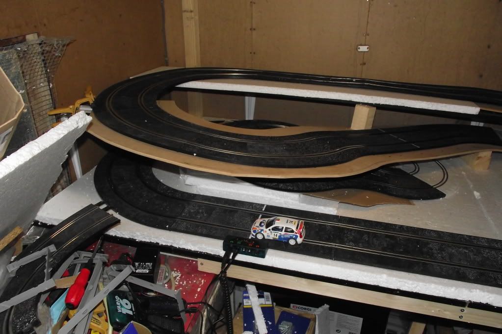

Ok a update, the last day of my holiday, first some gardening then on to the track.
Yesterday I glued part of the polystyrene on to the baseboard, only part as I forgot about glue and used just what I could find. Won't be getting any glue till I'm back at work, I get it cheap as I work in builders merchants, so I'm not paying DIY shed prices for it. Anyway I layed out the lefthand side of the track and set the levels then conected up some power and it seemed ok. All the suporting polystyrene to be glued during the coming week.
I the marked out and cut some 6mm MDF for the section that rises from the back right to the first level. Installed the track and tested it with a few cars.
To make testing easier I installed the second loop at the end of level 1 on the right and here are some videos of the testing, also used the Revell Mk1 Cortina, SCX Mini and Pioner Mustang. Was going to film my Power Slot Polo but this was the first casualty as it left the track at front and broke the guide when it hit the floor. For this reason I'm taking it easy in the videos.

One problem that may need a rethink is the most of the loop and also the snow track is hidden from view when standing near the track. The is not so obvious from the videos as they are taken lower down but can be seen in the photos. this is also probably the hardest part of the track to drive. As can also be seen in the videos there is a problem the some cars catching on the track at the back at one of the joins. This is a problem I have found with some Ninco track sections where the rail is higher in one piece than the other.
Anyway I will try and see what it's like if I'm seated when driving or I might have to revert to layout 3 (see above)

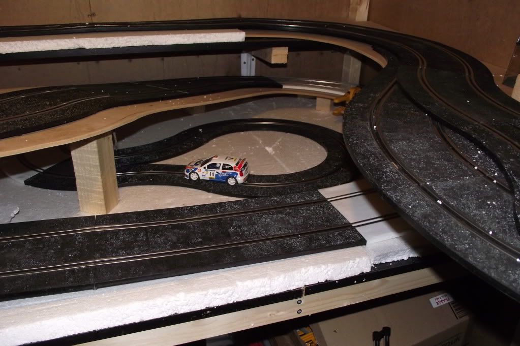

Ok changes to report.
Greenjo2 hight not a problem had room to play with the levels.
Anyway major changes, reverted to layout 3 but with the snow track in different places as per photos
As you can see I've been playing about with the levels to add a bit more interest, biggest problem was getting enough clerance for the crossover. I wanted to raise the loop but this left very little clearance. May try with com corrugated card or MDF under the loop just to rasie it a bit or may have to revert to the original curved raised part for the crossover (but that will mean recutting MDF).
I may be able to cut and join what I've alread used if I go that way.
Also it looks like I will need to find a way to fix the track in place, probably with glue in down in certain places and I don't think mdf as borders and plastered over will keep the track in place at some of the level changes.
