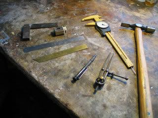

So I made an effort to collect a few tools.

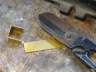

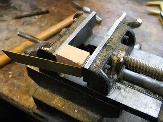

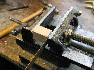

This is the way the new era dawns. An innocent scrap of 0.6mm brass waits to be hammered, beaten, and generally abused. A symbol of the oppressed masses.

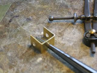

But the proletariat is not afraid of a little violence to bring about the necessary change. A scribe mark is struck across the brass strip, using the Engineer of Human Soul's sturdy steel square. The brass is fastened firmly in the vice of oppression, and it bends to the will of society. A perfect right angle symbolises our glorious change in direction!
The labour has only just begun. We need not just a change in direction, but a whole U-turn! We have to resolutely turn our backs on the past! Another bend. We use a block of our honest native timber, carefully fashioned to the width of a motor and squared to prescision under the patient eye of the worker.
We have turned another corner, comrades! But we have gone too far. We need to balance the left and right flank of our glorious advance.
The People's tinsnips are darkest black, and utterly ruthless.

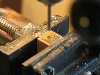

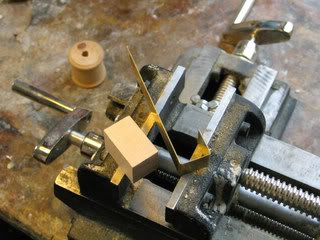

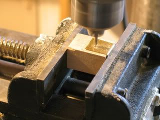

Next, we remount our faithful hardwood block, and go through the drill. A pilot hole...
Then a 5mm hole for the axle tube. Keeping the block mounted we can flip it in the vice and drill the opposite side in the same way, and be sure of alignment

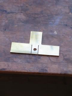

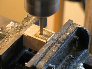

Next, we flip the block to show the middle face, and drill pilot holes for three more critical positions. These are the shackles by which the irresistable force of the powerful Motor of the People will be united with the trustworthy Chassis Contraption of Collective Power (Henceforth to be known as the C.C.C.P)
Some enlargement required to the centre
We decree that in the glorious future ALL holes will be drilled slightly undersize, so that perfect circularity and accuracy may be achieved with the People's Reamer.

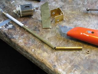

The bearing tube is prepared! The only acceptable way to cut brass tube under the New Regime is to take a rusty old Stanley Knife and roll it around remorselessly, until the hardened brass gives way to the will of the people.

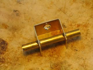

The axle tube of Immutable Force is fed through the accurately reamed holes of the People's Will, and four 2mm long scraps of suitably tenacious solder are laid in the joints using the mighty Tweezers of the Proloteriat, and brushed with the purifying liquor of acid flux...
And subjected to the purifying flame of compressed Gazprom's finest, piped direct from nature's own bountiful fields.
Files, the grinding emerypaper of poverty, and 00000 grade wire wool bring the People's U- bracket to gleaming perfection. Did the drones of the ruling classes ever produce such work by the humble toil of their own begrimed hands?

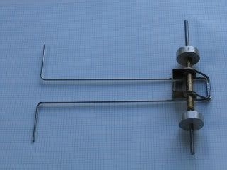

At the rear, we have added the yoke of finest home-produced steel to ensure that the transmission of the People's Power will not waver or falter in strength and utter determination. At the front, the straight path of the frame has been altered, with the aid of a fine engineer's red square, so that the forces of opposition will be dispersed safely.
Now we must forge the front axles- the vital part to ensure a straight passage, immune to the rocky and treacherous path that lies ahead of us, springing to meet the new dawn. The curious shapes, and the sliding brass barrels are a device as yet unknown to the reactionary forces of conservatism, but their true purpose will soon be unveiled to an astonished world.
Once more, the fine engineer's Red Square is brought into play, working in harmony with the People's Pliers.
And the wheels of industry are oiled and slid smothly onto the spokes of Revolutionary Thingie Socialism!

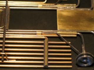

We then cut lengths of 1/16" tube to fit between the end tubes, and thread a length of piano wire through. We have created hinges. A means of expression to fellow travellers in this mighty revolution.
To the hinges, we then attach 1/16" brass rods, bent to the rule of the red square and the People's Pliers.
