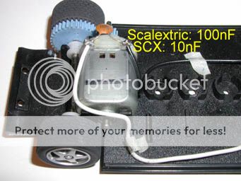

Scalextric/SCX:

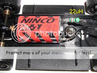

NINCO:

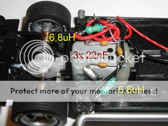

Cheap chinese 1:32 set car:
2,2nF = ceramic capacitor, 2,2 nanofarads
22nF = ceramic caacitor, 22 nanofarads
10nF = ceramic capacitor, 10 nanofarads
100nF = ceramic capacitor, 100 nanofarads
6,8uH = choke, 6,8 microhenrys
10uH = choke, 10 microhenrys
22uH = choke, 22 microhenrys
The last car on the list is from cheap track set similar to Artin. Price of the car is 6euros and still it contains 5 EMI suppression components. This is not price issue, so I wish that some manufacturers would take EMI more seriously.
If you have a car that disturbs your family life, all it takes is some inexpensive components and basic soldering skills to reduce EMI. Remember that soldering these components is not 100% cure, but in will suppress some of the disturbance.
