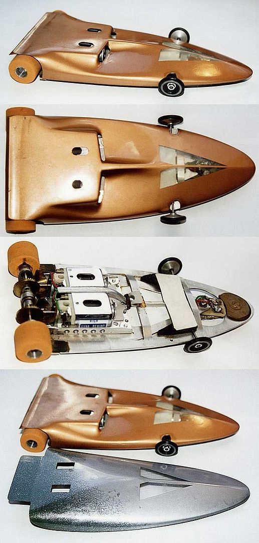

As for the Flat Iron, there were also a few bits and pieces of this legendary creation in Spader's remnants.
Not yet a complete car, but enough parts to further expand our knowledge of the Flat Iron's history some more.
A picture tells more than a thousand words, and below are pictures enough for a whole novel. Happy reading!
Above are the Flat Iron-related parts I've so far identified in the Spader legacy: Two bodies and a few bits and pieces
for a dual-engined chassis. One of the bodies is in almost pristine condition, but has also a broken and lost part in the
front. Unfortunately. Note the special "bulb holes" in the body for the front wheels, a feature not found on any other
know Flat Iron version. The overall finish of this body indicates that this may be a late (the last?) incarnation of this car.
The other body, on the other hand, is perhaps the most famous and well-known version of Spader's Flat Iron car.
At least here in Sweden, as this is the one "everybody" remembers from back in the day, as this version was represented
in pictures and articles in period magazines and books.
