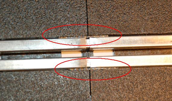

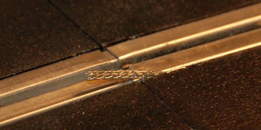

As a solution for Scaley track conductivity, I found a new solution though I haven't tested it yet on very long track sections. I'm sure I'm not the first one to have tried this technique, but anyway, here's how I did.
The principle is simple.
Buy some 3/64 inch width flat copper braid :
Cut it in chuncks of 3 centimeters. Insert them between the pastic track and the metal rail at each track connection :
It should look like this :
Bernard

I'm interested in finding out how well it performs for longer tracks. I'm also interested in hearing if there's an increase in problems with cars' guides getting wedged in the join. Scalextric rails are already quite close together, and some guides get stuck when a join has a narrow slot. I would expect this to increase that tendency.

The braid is just a bit thicker than the "natural" hole between the rail and the plastic part of the track. So it's true that rails get a bit closer but it's so imperceptible that I don't think you'll have more problems than you currently have with normal guides (by "normal", I meant non-Carrera).
