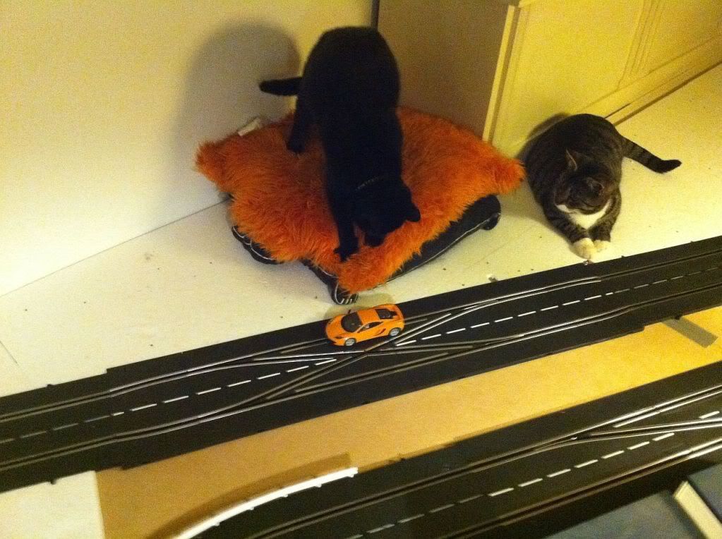

Top of picture the Carrera XLC on 99 mm gauge with converter pieces, down right the converted 90 mm. gauge Carrera single LC.
We've been racing the Xmas track now for weeks, and i haven't had any deslot on the long straight passing the 90-99 mm. converter piece.
You can actually drive over the long straight full speed, passing the converter gives a slight movement to the side, but it's never enough to destabilize the car. No deslots, no tail shaking whatsoever.
Ok, i have no report on how a ultra fast NSR would behave of course, i'm talking standard Scaley / Ninco / Slot.it cars here.
On the last pic a Scalextric crash resistant Porsche and a Ninco Lambo Gallardo. The last car is tuned up and is stunningly fast on the straights, but as i learned, no problems taking the XLC fast.
